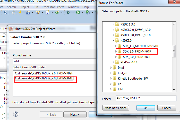

yiluxiangwan
Hi.
This is the case   :  Click  File>>New>>Kinetis SDK 2.x Project , Pop up a name is  Kinetis SDK 2.x project wizard   a window.      Select project name and SDK 2.x Path(root folder).
My problem :   I don't know what SDK 2.x  path is .  I can't search the local document for information about it.
                         Can you tell me how to find the SDK 2.x  path?

Hello ,
The root folder is the folder you download , for example for the SDK_2.0_FRDM-K64F,
when you download it , it is a compressed files "SDK_2.0_FRDM-K64F.zip", please unzip it , when you create project,
the path is the folder "SDK_2.0_FRDM-K64F" (you can put this folder to anywhere ):
Hope it helps
Alice

yiluxiangwan
I'm using K60.Nxp website is no K60 SDK 2.0,only have  SDK_1.3_TWR-K60D100M .  So,I cannot create about K60 kinetis SDK 2.x project.
I think this is the case.
Thank you.
3,292 Views
ivadorazinova
yes exactly, because K60 is not supported by current KSDK 2.0.
