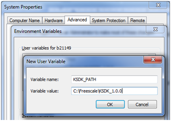

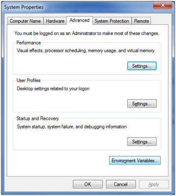

  • After the installation of KDS the environment variable “KSDK_PATH” must be defined. Under “System Properties” go to “Environment Variables…” located in the “Advance” tab.
  • Add the new variable under “User variables…”. The name should be “KSDK_PATH”. The path is the same where by default the KSDK is installed. In this case the path is “C:\Freescale\KSDK_1.0.0”.

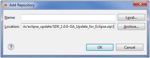

  • The KSDK patch must be installed before to proceed with any project creation. To do this click in “Help” menu and then “Install New Software…“ option.
  • Click in the “Add…” button and then “Archive” button. Look for the file “C:\Freescale\KSDK_1.0.0\tools\eclipse_update\SDK_1.0.0-GA_Update_for_Eclipse.zip” and click “Ok” button.
  • Select the “Eclipse Update for KSDK 1.0.0-GA” option from the options and then press the “Next” button.

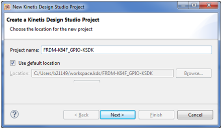

  • Next step is to create a new KDS project. Go to “File>New>Kinetis Design Studio Project” option
  • Then give a name; easy one, to remember what it does. Then press “Next”

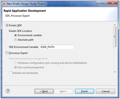

  • Check the "Kinetis SDK" check box. Make sure that "Processor Expert" is not checked.
  • Project is now created and it is ready to include the source code.

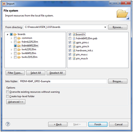

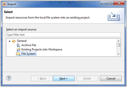

  • All the KSDK examples include the "board" folder. It is necessary to do the same for this new project. To add it just right click in the project just created and chose "Import".
  • Select "File System".
  • Look for the board folder in the following path: C:\Freescale\KSDK_1.0.0\boards\
  • Chose the C and H files only from the "frdmk64f120m" folder. Just like this:
  • Then the folder "frdmk64f120m" is added to the project structure.

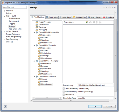

  • Following is to add the KSDK library in the compiler. To add it you need to give a right click in the project and click in "Properties". Under "C/C++ Build" menu go to "Settings". Then click in "Miscellaneous" under "Cross ARM C++ Linker". If you did it correctly then you will see this:

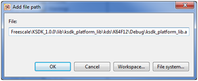

  • Click in add object button 14168_14168.pngpastedImage_170.png  and add the library here. The default path is "C:\Freescale\KSDK_1.0.0\lib\ksdk_platform_lib\kds\K64F12\Debug\ksdk_platform_lib.a".

I have a relatively clean install of KDS 1.1.0 GA and KSDK 1.0.0 GA.  When trying to add the library from location  "C:\Freescale\KSDK_1.0.0\lib\ksdk_platform_lib\kds\K64F12\Debug\ksdk_platform_lib.a", I don't have the library file or even the DEBUG folder.  Do I need to build a different project first?
Thanks and regards,
Norm
Hi Garabo,
I found my issue - I needed to build the KDS platform driver library per Appendix A of the Kinetis SDK K64 User's Guide.
Thanks for the great work!
Norm

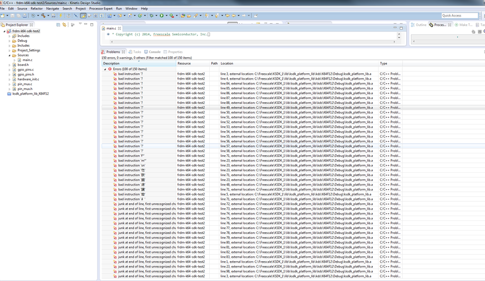

i have added the headers properly to inclues but still getting this errors everytime,
http://oi62.tinypic.com/n14ff7.jpg
plz help
Hi Kane,
Please try to compile the KSDK library. These errors are cause by two issues:
-KSDK lib is not compiled
-KSDK library is not added to the in the linker setting: 14167_14167.png
I hope this solved the problem
Garabo
