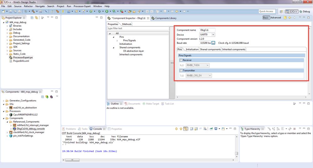

I'm just getting started with KDS 3.0 and KSDK 1.2 and am in the process of recreating the work I've previously done with KDS 2.0 and KSDK 1.1.
I would like to be able to use debug_printf with the DbgCs1 component on a custom MK64FN1M0VLL12-based PCB.  I also want to communicate with other peripherals over RS485 or RS232.  I believe I have a problem with the routing, because the RS485 connection is routed to PTB16/PTB17, which is allocated to UART0.  Since JTAG is also connected to UART0, then I assume this means I'm going to have to re-route the signals, or just not use that port until the next rev.
So in short, I take it that the proper design methodology behind incorporating Kinetis processors is to first look at the UART that shares pins with the JTAG connections, and then prevent usage of this UART on any of the other pins that provide access to that peripheral?

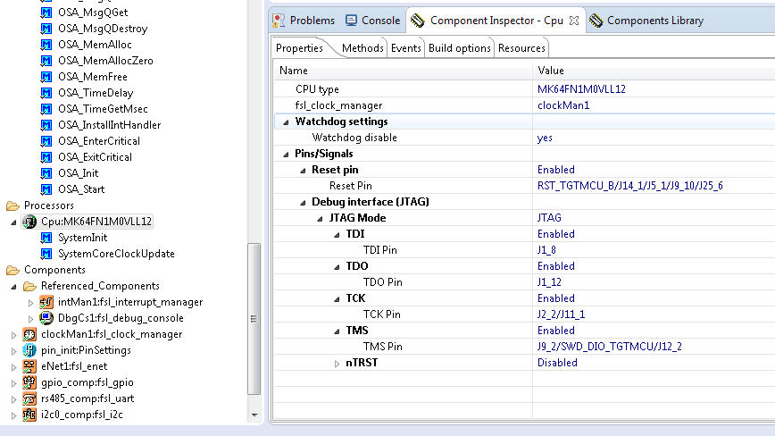

In addition, when I select those pins in DbgCs1, I get a conflict with my CPU settings:
What is the right approach for supporting debug_printf over JTAG and JTAG if I'm getting conflicts in the PEx definitions?

Hello Alice,
You should choose the UART which you want to use and re-route to specific pins.
If you don´t want to use UART, you can disable pins for UART0 and set Baud rate.
fsl_dbg_console is always needed (it is required from OSA layer).
I hope this helps,
Iva

Hi Alice, I'm using KDS 3.0 and KSDK 1.2.  Here are some extra screenshots, as I'm not sure which you're really looking for.
To get around my problem, I have temporarily set DbgCs1 to use UART3:
What I'm not understanding is that I thought that debug_printf could be redirected over the JTAG connection and show up in the console window in KDS.  I don't know how to make this work, but it seems that DbgCs1 is not the component that allows this.  Am I correct that DbgCs1 must be assigned a physical UART because it can really only output to a terminal program?  But if this is the case, why would MQX require DgbCs1 when it can somehow output to the KDS console (via semihosting?).  Shouldn't there be a way to disable DbgCs1 if we don't need it and actually want to use UART0 for other things?

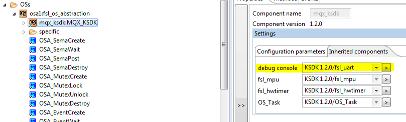

In the process of debugging another project that I am currently porting, a related issue came up so I'd just like to summarize the questions I have about DbgCs1, UARTs, and fsl_debug_console:
  1. In an MQX Lite configuration, can I remove DbgCs1 completely without causing PEx to give me errors when I generate code?  It seems to really want a debug console interface.  Currently, I just assign DbgCs1 to UART3 and will avoid usage of this peripheral in my code.
  2. In an MQX Standard configuration, I *must* disable DbgCs1 per a previous conversion I had with you in another post, but I still have to associate mqx_ksdk with a "debug console" component.  Currently, I assign it the only selection from the droplist (KSDK 1.2.0/fsl_uart), and then configure this component to also use UART3 as above.
  3. Why does there seem to be a requirement to assign a debug console to a physical peripheral if I am using semihosting for printf?  Is the debug console used for anything else by the KSDK?

Hi Dave,
About the MQX project on KSDK,  it same to be that the mqx_ksdk component must be conclude the "fsl_debug_console" component.
While i do not know why , i have test on many chip.  I think it just a way of design.
And printf using semihosting is not need physical peripheral . As Erich menntiond" using semihosting only needs an active debugger connection, and not a physical UART."
And i do not know why you printf to semihosting ? It is will generate big size code , please see here :
Why I don’t like printf() | MCU on Eclipse
Alice

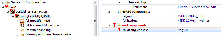

dave408
Senior Contributor II
Hi Alice, thanks for your info about debugging to the console window.  I will give that a try.
Regarding your #2 above, my question is based on the observation that if I disable the DbgCs1 component, I then end up with an error in the osa1 component because it's expecting to have fsl_debug_console defined:
I'll give the semihosting info a try now to see how it works.
