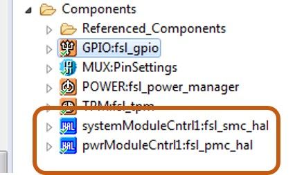

There is still left to enable VLLS modes on SMC_PMPROT register. (On reference manual, see section 15.4.1 Power Mode Protection register) and also, restore peripherals I/O (because there are latched when being in VLLS mode), this is done by clearing ACKISO flag in PMC_REGSC register (section 16.5.3 Regulator Status and Control register).
You should add fsl_pmc_hal and fsl_smc_hal components to your project:
Generate code for being able to use PMC_HAL_GetAckIsolation() and SMC_HAL_SetProtection() functions.
First, you need to recover the I/O peripherals when entering from RESET and after that, you need to allow VLLS mode, it is done just after entering main function:
