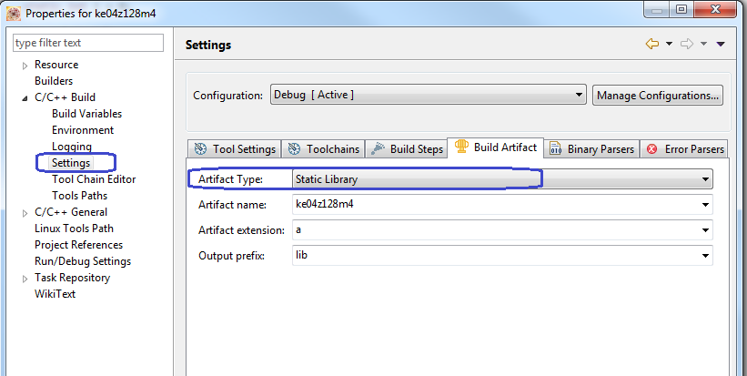

Is there a way to create a custom library project using KSDK?  Making a new "kinetis project" includes all the board files locally and overrides an actual applications ISRs and things if compiled as a library and included in the project.

Please open the Properties for your project, you can do it from <Project> Menu->Properties, or put your mouse on the project view in Project view, and choose <Properties> in right-click submenu.
Then go to <C/C++ Build-> Settings> panel, click on ‘Build Artifact’ tab, choose ‘Static Library’ for ‘Artifact Type’, and rebuild the project.
