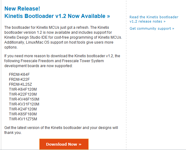

Hi there,
I received an email re Kinetis Bootloader update but K60 is not included in the below list. Is there an updated USB bootloader for K60?
Thanks.
Devan
1,417 Views
jeremyzhou
Hi Devan,

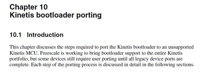

The KBOOT V1.2 hasn't supported the K60, however you can port the exit bootloader demo to K60 by refer to KBOOT reference manual.
Hope it helps.
