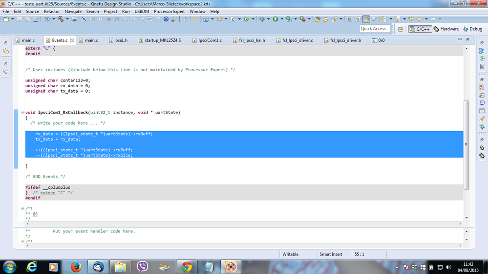

I'm developing a project with MKL25Z128 and I'm making some tests with LPSCI, using "fsl_lpsci" Processor Expert bean, but I have run into some problems:
I created a simple routine: I receive a character typed on a Windows Terminal like Tera Term, for example, and send back (echo) to the Terminal.
When the rx_buffer full Callback function is enabled, as well as the ISR Handler, I don't receive any data typed from Terminal. I put a breakpoint inside ISR_Handler after SCI Receiver Buffer Full flag checking line, but it doesn't stop there. When Rx_Callback function and ISR Handler are disabled, it works perfectly.
I don't know if I did something wrong. I have spent many hours of attempts strugling on that.
I hope someone has faced the problem as mine and can help me with that.
I attach my simple code for better visualization.

Kan_Li
Hi Marco Coelho,
How about implement callback as below:
void lpsciCom1_RxCallback(uint32_t instance, void * uartState)
  /* Write your code here ... */
    ++((lpsci_state_t *)uartState)->txBuff;
    --((lpsci_state_t *)uartState)->txSize;
Hope that helps,
Kan

Hello, Kan
It is working now. I was suspicious about the "LPSCI_HAL_Getchar" function call in "LPSCI_DRV_IRQHandler". As said in my last message, whenever this function is called, it hangs, untill falls into a "Default_ISR".
I confirmed what I suspected, when I simply commented this function call and inserted the following code in place:
"lpsciState->rxBuff = UART0_D;"
In other words, I included exactly the same line that is inside "LPSCI_HAL_Getchar" function.
So, there may be a kind of strange bug that doesn't allow the correct call and execution of this function.
Your tips were very helpful. I had to add some code, like increasing the "lpsciState->rxSize" after receving the last character. That was a way I found to set "Receive Status" back to "kStatus_LPSCI_RxBusy" and therefore, to avoid sending the last typed character back to Terminal eternally. My test is a echo, so I want the character typed on Terminal to be sent back to PC only once. I don't know if there is a more correct way to do this.
Bellow, you see the modifications I did in the code that I originally attached to this discussion. The changes were in main.c (main loop), Events.c (RxCallBack function) and in fsl_lpsci_driver.c (LPSCI_DRV_IRQHandler function).  It was tested on FRDM-KL25Z and I used OpenSDA Virtual COM for communication.
Thanks you very much and best regards,
Marco Coelho

After debugging the code, I found the exact point where it hangs. The first time I type something on the Terminal, in "LPSCI_DRV_IRQHandler", it calls "LPSCI_HAL_Getchar" function, but it never returns from there, and falls into a Default_ISR, but I don't know why.
    /* Handle Rx Data Register Full interrupt */
    if((UART0_BRD_C2_RIE(base)) && (UART0_BRD_S1_RDRF(base)))
        /* Get data and put in receive buffer */
        LPSCI_HAL_Getchar(base, lpsciState->rxBuff);
9,888 Views
MAPC
Senior Contributor I
Hi, Kan
I included the code above in RxCallBack function as you recommended, but it didn't take any effect.
Any other tips, hint?
Have you ever tested it on your side? Do you have a simple functional echo example code with RxCallBack function enabled on FRDM-KL25Z? Could you please provide it to me?
Thanks and best regards,
Marco Coelho

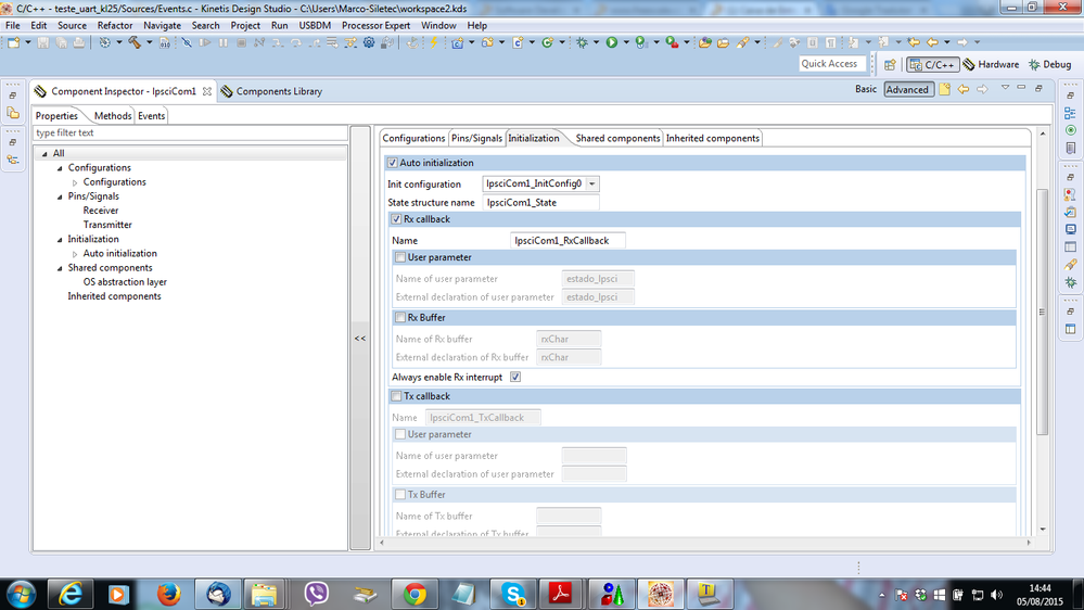

MAPC
Hi, Kan
Great! Your solution really works! I made some mistakes. I thought "LPSCI_DRV_ReceiveData" function should not be used in Interrupt driven mode and I supposed this could be causing the failure.
I came back to the old code in main loop, by calling "LPSCI_DRV_ReceiveData" function and checking the LPSCI Status. And when this function is called in main loop, I don't have to access ((lpsci_state_t *)uartState)->rxBuff and store it in my rx_data variable inside RxCallBack function anymore.
I also understood it is not necessary to define a "User Parameter" and "Rx buffer", as well. So I disabled them in lpsci bean.
After that, in LPSCI_DRV_ISR_Handler, I commented the line:
    //lpsciState->rxBuff = UART0_D;
and uncommented the line:
So, its original content is back and no more hanging and no more Default_ISR!
And, now, everything is working perfectly!
Thank you very much for your support, Kan!
Marco Coelho

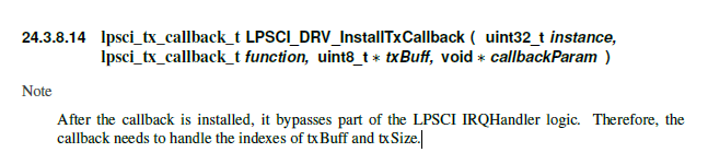

Kan_Li
Hi Marco Coelho,
Because after the callback is enabled, it bypasses some part of the LPSCI IRQHandler logic, so if you installed rx callback, you have to  handle the rxBuff and rxSzie in the callback function. and your callback function is just an empty function, so the receiving driver could not get any data from the terminal. Please refer to the following for more details.

Hope that makes sense,
Kan

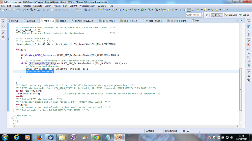

MAPC
Ok, Kan
Following your instructions, I modified my code in loop for in main.c to:
  for(;;){
          // Wait until we receive a user character
          while (kStatus_LPSCI_RxBusy == LPSCI_DRV_GetReceiveStatus(FSL_LPSCICOM1, NULL)) {}
          LPSCI_DRV_SendData(FSL_LPSCICOM1, &tx_data, 1u);
          while (kStatus_LPSCI_TxBusy == LPSCI_DRV_GetTransmitStatus(FSL_LPSCICOM1, NULL)) {}
And left RxCallBack function just like that:
  tx_data = rx_data;
But it is not working yet.
Did I forget any detail?
Thanks and regards,
Marco Coelho
