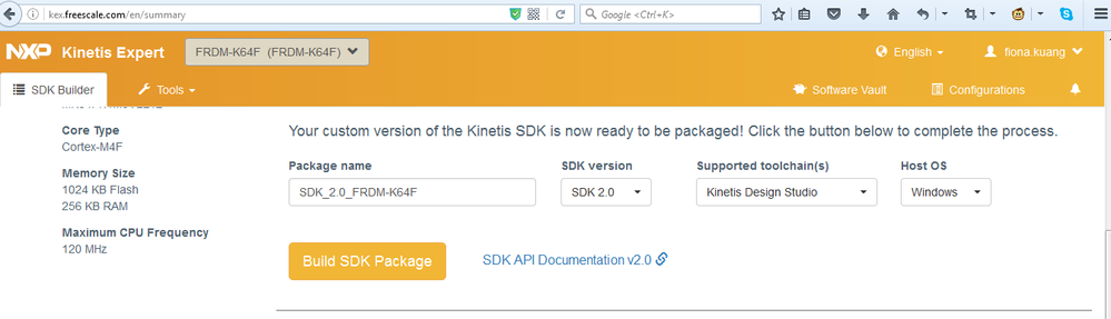

TICS_Fiona
Hello Mehmet
SDK 2.0 includes the code example for UART driver, you can download it from:
http://kex.freescale.com/en/welcome
Please click on ‘Build an SDK’ to choose the FRDM-K64F board.  Then click on ‘Build SDK Package’ button and download the package.
After unzip it, you will find the UART examples under its subfolder:
..\boards\frdmk64f\driver_examples\uart
