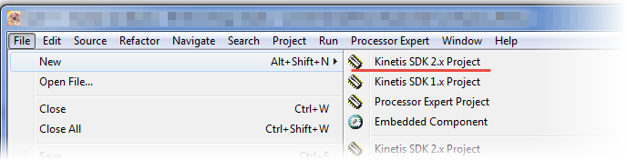

I have no processors or boards available when creating a new project in KDS V2.0. I tried reinstalling KDS, still the same. I am running Win 10 64 bit on a core i7. I want to use my FRDM KL25Z board to begin with

The window says "contains processors" or "contains board support" but there is nothing there. I can'@t move on from here.

Hi Peter!
1) Please, go to https://nxp.flexnetoperations.com/control/frse/product?entitlementId=123521727&lineNum=1&authContact...  and download the newest KDS v.3.2.0, please see also New Kinetis Design Studio v3.2.0 available
2) do you want to create new KSDK project? If yes, you should have downloaded package for your KL25Z from http://kex.freescale.com/ with the procedure described here How to: install KSDK 2.0 and create new project via wizard or project generator tool, please see New Kinetis SDK Project Generator v2 is available!
Please let me know in case of any issue,
Iva

It is actually KDS V3.2. sorry.
