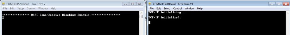

Dear community, please I need to ask an explanation for a weird issue I'm having using the "lwip_udpecho_demo" example (under c:\Freescale\KSDK_1.3.0\examples\twrk65f180m\demo_apps\lwip\lwip_udpecho_demo\udpecho_rtos). But, in my opinion, the issue is not due to the SPECIFIC demo example I am using. I guess it's use to MQX RTOS.
Unfortunately my deadline will be this incoming Monday. If I don't fix this issue I cannot deliver my project... :-(
ENVIRONMENT I AM USING
- KSDK 1.3.0
- TWR-K65F180 with TWR-SER2
- MQX RTOS
- PEMicro
- Either openSDA or Jlink for debugging
- PC console: either DB9 on TWR-SER2 or openSDA
- GNU-GCC Compiler
DESCRIPTION OF THE ISSUE
"lwip_udpecho_demo" code example uses UART2 to display debug strings on the PC-console. I need to make this TWR board communicate with another TWR-K65F180 with TWR-SER2 over UART. So I tried to use, in vain, either UART0 or UART3 (from, respectively, J7 pins 1 and 3 of TWR-SER2 and R40 (PT17) and R39 (PT16) of TWR-K65F180 board. The issue I'm having is that, when my code tries to transmit over UART0 (or UART3) using "UART_DRV_SendDataBlocking(0, bufferData, byteCountBuff, 1000u)", it always crashes inside this function (more precisely, when this function calls "retVal = UART_DRV_StartSendData(instance, txBuff, txSize)").
MY ANALYSIS OF THE ISSUE
I also tried to transmit data over UART0 and UART3 (same boards configuration) with the example "uart_blocking" present in the driver examples of the KSDK 1.3.0 folder. In this case I had not problem in term of that, everything worked perfectly! So, since this "uart_blocking" example is not using any RTOS, my guess is that MQX, for some reasons, keeps busy both UART0 and UART3 making my code crashing.  But, in the code, I didn't find the point when MQX opens these two ports.
Can this be the right explanation? But, more important, how can I use these two UARTs (0 and 3) using MQX RTOS in my code?

About your first question, I can say, yes, you can, and I've made some modifications on lwip_udpecho_demo_mqx_twrk65f180m example to validate it. I attach this main.c file for your reference but I will explain all that I've done in order to get this UART driver to work.
First of all, I included the "fsl_uart_driver.h" file.
#include "fsl_uart_driver.h"
Then, I defined UART 3's handler as it is explained on this document:How To: Using Interrupt Handlers in MQX with KSDK (You can also check this useful post Interrupt handling with KSDK and Kinetis Design Studio)
extern void UART_DRV_IRQHandler(uint32_t instance);
void MQX_UART3_RX_TX_IRQHandler () {
    UART_DRV_IRQHandler(3);
After this, on Main task, I configured the UART module (pins, baud rate, etc) and all necessary variables:
const uint8_t buffStart[]   = "\r\n++++++++++++++++ UART Send/Receive Blocking Example +++++++++++++++++\r\n";
    // Inform to start blocking example
    uint32_t byteCountBuff = sizeof(buffStart);
    // Initialize variable uartState of type uart_state_t
    uart_state_t uartState;
    // Fill in uart config data
    uart_user_config_t uartConfig = {
        .bitCountPerChar = kUart8BitsPerChar,
        .parityMode      = kUartParityDisabled,
        .stopBitCount    = kUartOneStopBit,
        .baudRate        = 115200
    /* UART3 pins on PTE4 and PTE5 */
    /* Affects PORTE_PCR4 register */
    PORT_HAL_SetMuxMode(PORTE,4u,kPortMuxAlt3);
    /* Affects PORTE_PCR5 register */
    PORT_HAL_SetMuxMode(PORTE,5u,kPortM
uxAlt3);
UART 3's handler is installed through OSA layer:
OSA_InstallIntHandler(UART3_RX_TX_IRQn, MQX_UART3_RX_TX_IRQHandler);
Finally, I initialize the module and send a basic message:
if (kStatus_UART_Success != UART_DRV_Init(UART3_IDX, &uartState, &uartConfig)) {
        printf("Error on UART initialization\r\n");
    } else {
        UART_DRV_SendDataBlocking(UART3_IDX, buffStart, byteCountBuff,1000);
After this, demo is unaltered and you can see that both UART instances (UART2 as I/O console and UART3) print messages on terminals:
This way, you can see that UART can be used as it is used on baremetal examples.
