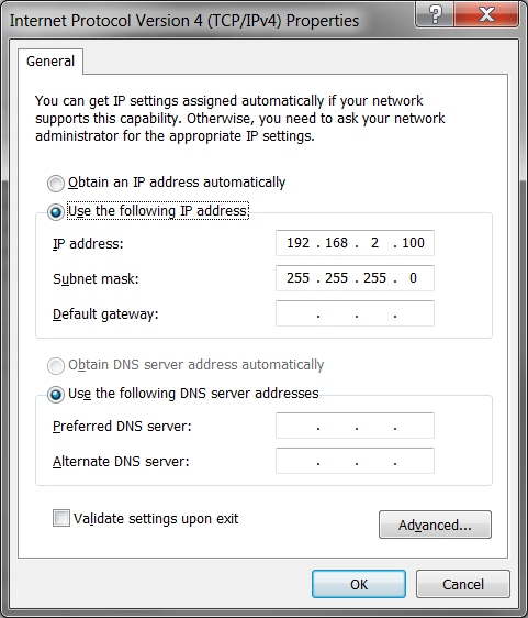

MY PC CONFIGURATION
I sent a "ping 192.168.2.102" to the board from the Windows command console (as explained in "Kinetis SDK v.1.3 Demo Applications User's Guide.pdf"). I configured my PC with the fixed IP address = 192.168.2.101, Subnet mask = 255.255.255.0 and Default gateway = 192.168.2.100. I also tried to configured the PC with Default gateway = 192.168.2.101 (i.e. same of the IP address). Here attached you can find a screenshot of my LAN configuration. The software in the tower board is not giving any positive answer to the ping message.
I tried to do the same thing with the ping example. Same result, no answer to a ping message.
Please, can anyone tell me how to make this example working on twrk65f180m?

In terms of PC configuration, please see the following picture (David, I can't leave gateway IP 0. You meant empty as in the pic here attached, correct?). I connected the TWR-SER2 directly to my PC. The latter, was once connected to the company's LAN and, during another test, just to the TWR-SER2.

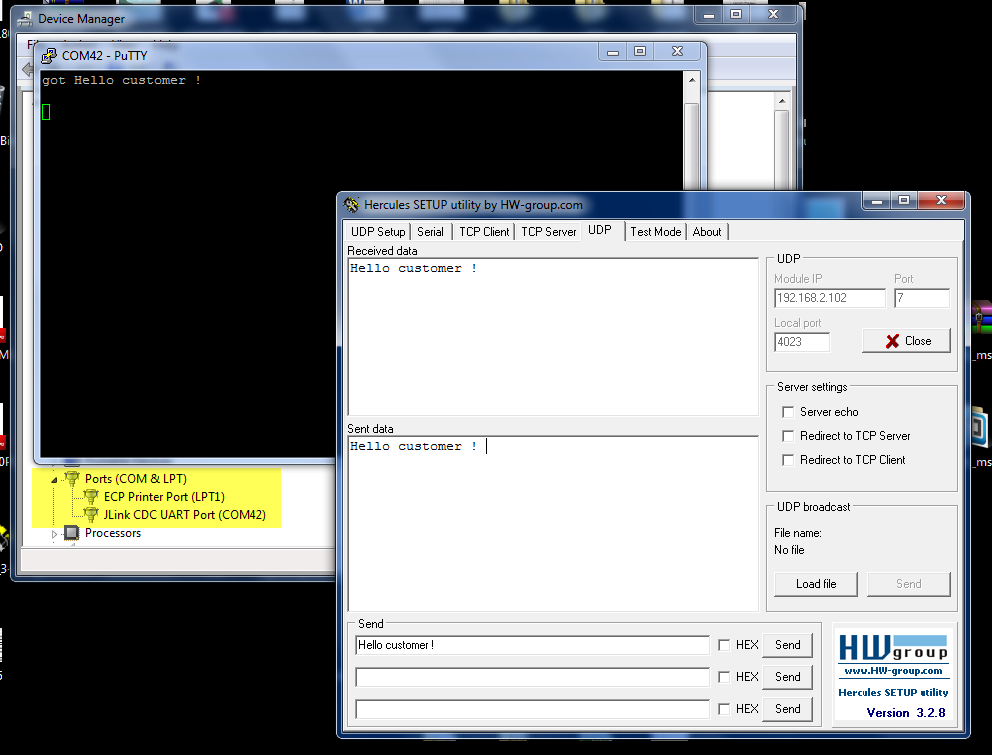

BUT I FOUND A "WEIRD" WORK-AROUND THAT MADE IT WORK!
But this is not supposed to be the right procedure provided by Freescale to run this demo. So, somewhere, there is something wrong. This is the procedure I followed in both released and debug modes:
a) Connect the ethernet cable to ETH port A of TWR-SER2 and run the demo. It does NOT reply to a "ping 192.168.2.102" command. I also tried lots of time to reset the board.
b) Connect the ethernet cable to ETH port B of TWR-SER2 and run the demo. It does NOT reply to a "ping 192.168.2.102" command. I also tried lots of time to reset the board.
c) Reconnect the ethernet cable to ETH port A of TWR-SER2 and run the demo. After different resets of the board (at the beginning it didn't work), it replies to a "ping 192.168.2.102" command. From now on it's working.
Any explanation about that?
