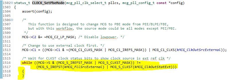

So we place several GPIO to toggle LEDs to trace the critical issue and found the system is stuck in "CLOCK_SetPbeMode" while loop to check external reference clock.

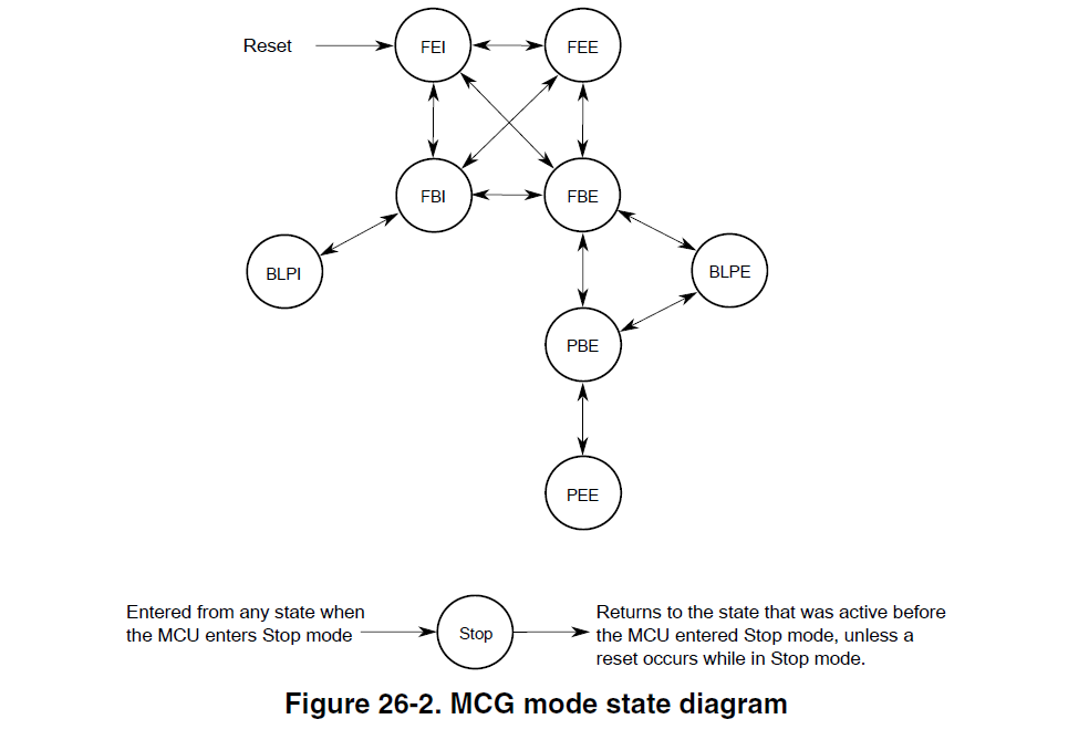

marek_neuzil
Hi Kyle,
The problem is that the BOARD_BootClockRUN() suppose the after-reset state of the MCG (FEI mode). If you use this method in the PEE MCG mode the behavior can be undefined.
It is caused by design of the MCG device that must be driven according to the following state diagram:
I.e. the BOARD_BootClockRUN() function provides transition from the FEI to the FBE, PBE and PEE modes of the MCG. But when the MCG device is in the PEE mode  and the BOARD_BootClockRUN() function is executed the behavior of the MCG device is undefined.
In your use case, you can for example use directly the CLOCK_SetPbeMode() function (fsl_clock.c driver) that support transition from PEE to PBE mode and reconfiguration of the PLL device and then you can set the PEE mode by using the CLOCK_SetPeeMode() function.

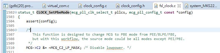

kyleyang
Hi Marek Neuzil,
Yes, I know this clock transition flow and need to follow it when change the clock mode.
But according to the description in "CLOCK_SetPbeMode" API as attached snap shot.
This API can directly transition to PBE from any mode except PEI/PBI.擷取.JPG

marek_neuzil
Hi Kyle,
You are right, you can directly use the CLOCK_SetPbeMode() function (I have already recommended it). But the BOARD_BootClockRUN() function contains a call of the CLOCK_BootToPeeMode() that also writes into the OSCSEL bitfield of the MCG_C7 register. It can cause the issue (even though it select the same clock source).
