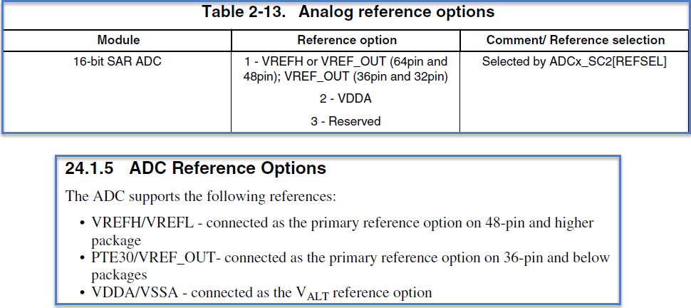

Hi All,
I would like to use the internal 1.2V reference as the refernece for the ADC. Both the datasheet and reference manual suggest this should be possible, however it's not obvious how to configure it.
The only options for reference sources in the ADC config are Vrefh orValth. For Valth it says refer to the chip configuration information (which I assume is the datasheet), but there is nothing there either.
If I select the ALR reference, I get results as though the reference voltage is still 3.3V.
Any sugegstions?

Jorge_Gonzalez
Hello Nick:
I have investigated further on this issue and these are my findings:
1) This is the information in the Reference Manual:
Your device is a 32-pin KL17, so the primary reference option (default reference) is VREF_OUT, while the secondary option (VALT) is VDDA/VSSA. Actually I was wrong that VREF_OUT was the VALT option. Sorry for the confusion.
2) About the KSDK VREF driver, I agree that the TRIM setting is an oversight. I will report this to the developers.
Let me know if you have further doubts.
Best Regards!
Jorge Gonzalez

nickdolling
Hi Jorge,
Thanks for clearing this up... I had read the section on the ADC numerous times but not picked up the primary/secondary reference subtleties... it would probably help if the Register definition section where REFSEL is described it used the same terminology ie "Primary/Secondary" rather than (or as well as) "Default/Alternate".

I measure 1.194V on the 100nF capacitor on PTE30, so it appears the reference is enabled and working.
I measure 0.479V at the ADC channel pin, and with the .refVoltSrc = kAdc16RefVoltSrcOfValt, I get a conversion result of 0x093 (147d), which seems to suggest the reference votlage is 3.3V.
I just noticed however that if I select .refVoltSrc = kAdc16RefVoltSrcOfVref, the conversion result is 0x19E (414d), which looks like the reference is 1.2V nominal.
I have checked the value of the REFSEL bits in ADC0_SC2 and kAdc16RefVoltSrcOfValt sets REFSEL = 1 and kAdc16RefVoltSrcOfVref sets REFSEL = 0, so the SDK is setting the right values however the effect seems the be backwards... REFSEL = 1 appears to select the Vrefh whereas REFSEL = 0 appears to select Valth..
Is it possible that either the documentation of the REFSEL bits (or the silicon implementation, since the way it's documented seems logical) is backwards?
