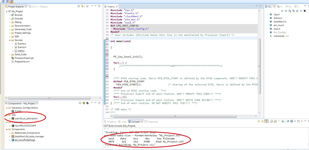

Ciao,
I created the project with processors Expert, but I realized that the dimensions are exaggerated ...almost 10K to configure only the micro KL03CSP without adding any driver !!
Oss then you can not implement?
How can I reduce the size?
Thank you
Original Attachment has been moved to: My_Project.zip
1,195 Views
santiago_gonzal
Processor Expert adds a lot of overhead. You can find attached a standalone project for KSDK 1.3 and KL03. You can create something similar using the KSDK Project Generator. It only uses 1Kb of Flash.
