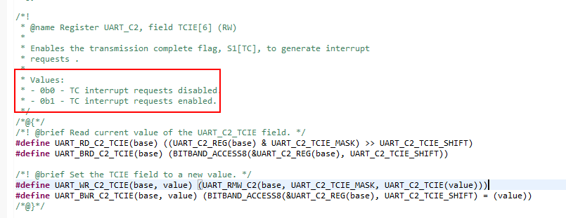

You can use this code to enable the TC interrupt :
UART_BWR_C2_TCIE(UART1, 1u);
It is defined in the file of :MK22F51212_extension.h  (KSDK_1.3.0\platform\devices\MK22F51212\include)
Hope it helps

Hello Alessandro,
- I think you can enable the TC interrupt on the UART of initialization code .
- Yes , you need install  the TCcallback() function by yourself  , you can refer to the "UART_DRV_InstallTxCallback" function .
