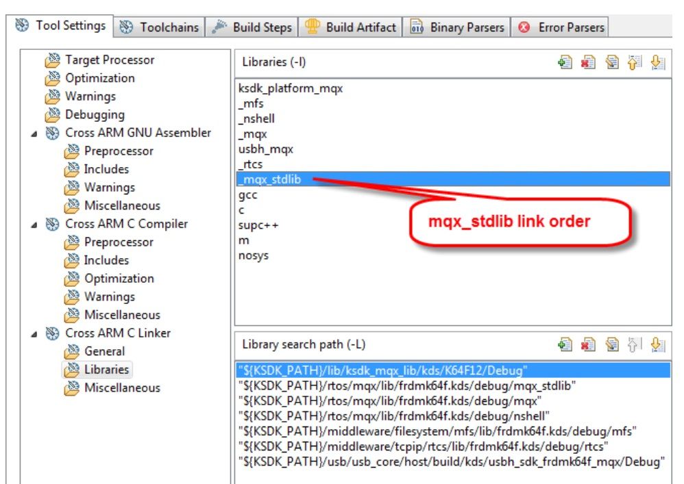

I finally found how to resolve this issue, by reading the document annexed. The problem was related to the order of the including libraries in the project. The mqx_stdlib should be included after the others user libraries and before toolchain libraries.
Thank you everyone for the help!

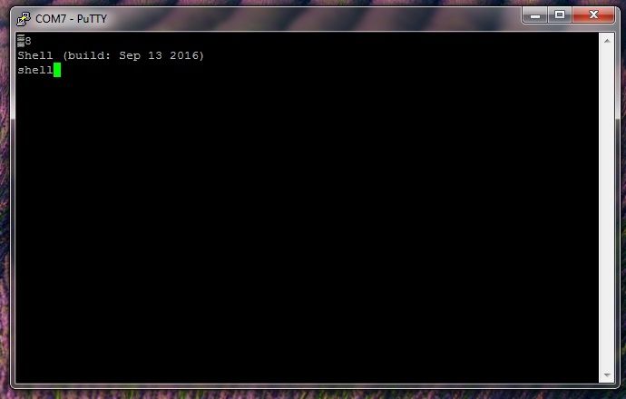

I am utilizing the KSDK Project Generator 2.2 to create my projects. When I include the library of shell by the normal way in kds (.a static files) the bug that I described occurs. When I use processor expert and include the library in the same way the shell works just fine. However, in the project without PEx, when I include the .c and .h files of shell in my project as if they were part of it, the project works normally. Here is a picture of what I see on my terminal screen:

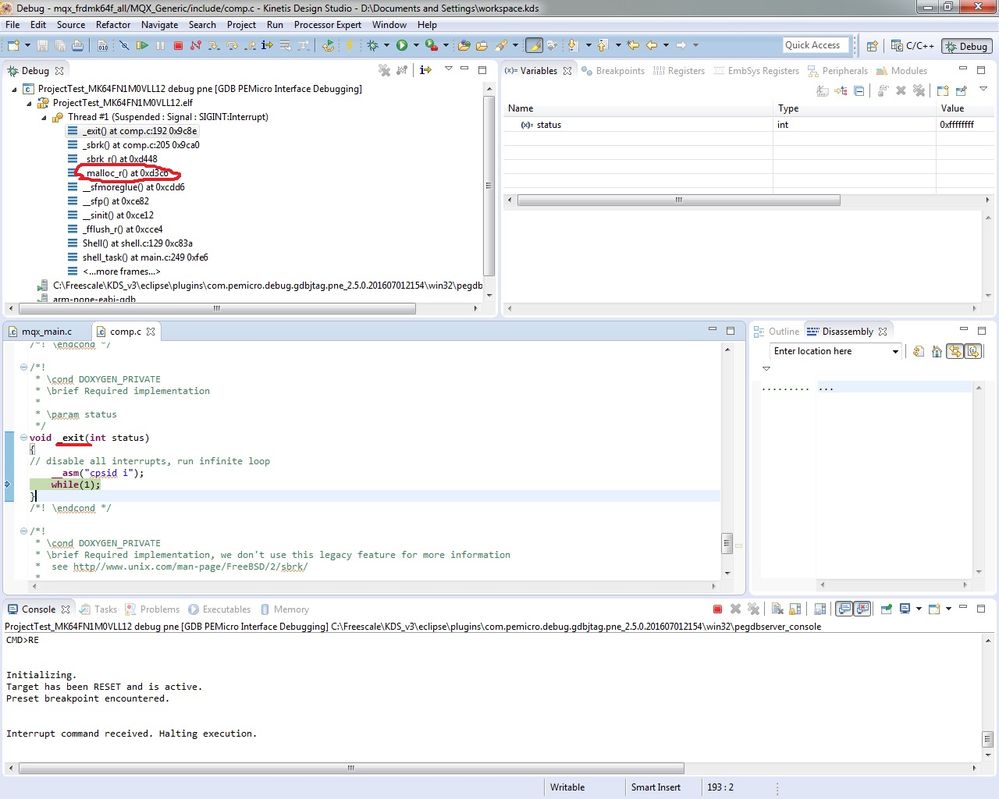

After the mqx exit, in the upper part of the KDS we can see the last called functions. One of them is _malloc_r(), as you can see in the image bellow, could this problem be related with the dynamic memory allocation?
So again I am asking for the help of community, someone have already seen this problem?
