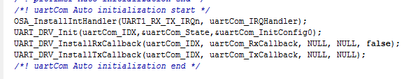

 UART_DRV_SendDataBlocking(uartCom_IDX, (uint8_t*)("this is a"), 9, 50u);
The receiver can only receive a bunch of "tttttttt..." , Use UART_DRV_SendData() enter an infinite loop, output one letter "t" at a time

My software can work correctly on FRDM - K22, The same software can't run on MK22FN128xxx10, software configuration USES is KDS3.2, KSDK1.3 library have compatibility problems

you need to install interrupt handler.
1] if you are using processor expert then enable "Install Interrupt".
2] If using KSDK without processor expert you can add it manually.
* API is :
osa_int_handler_t OSA_InstallIntHandler(int32_t IRQNumber,osa_int_handler_t handler);
* For example for UART1:
  OSA_InstallIntHandler(UART1_RX_TX_IRQn, uartCom1_IRQHandler);
 * Handler can be write as follows....
void uartCom1_IRQHandler(void)
UART_DRV_IRQHandler(UART1_IDX);
Let me know if any...

Tracking found UART_DRV_IRQHandler has been unable to perform, and the reason for the error in this
