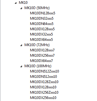

I have problem in identifying the support of the SDK for the following processors:
MK10DN32VMP5
MK10DX32VMP5
MK10DN64VMP5
MK10DX64VMP5
MK10DN128VMP5
MK10DX128VMP5
Are any of supported???

Hello Pietro,
thank you for this very good question.
I checked your mentioned MCU and SDK support MCU and there is a main difference - there are different processors,
so there is no direct SDK support, but - I see support of KDS, so you can modify the code for KSDK.
I attach you the guide.
Does it help you?
Iva

Dear Pietro,
I am afraid that there is only support for the Kinetis K10 that runs at 100 MHz (MK10DNxxxxxx10 and MK10DXxxxxxx10).
Earl.

Similarly,
Is the Kinetis K70 at 120Mhz supported by the KSDK?
Thank you!
4,572 Views
ivadorazinova
Hello Joe,
TWR-K70F120M will be supported in KSDK 1.3.
we expect it in Q3.
Iva
