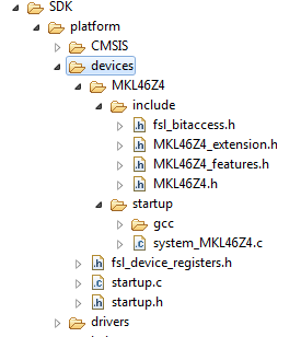

this is how it should look like in 1.2.0, it is for different processor but general structure is the same. Did you click on generate code button in your 1.2.0 PE project?
PEx will update the project content based on selected path to SDK and ksdk_manifest.xml file in root of SDK. However PEx do not adds system_<DEVICE>.h file from SDK. This file is generated into following location by clock_manager_component (this component also generates structure for the driver).

as I wrote in my last answer to you and Jorge, the file "system_MK64F12.c" was back in the startup folder when I started the project from scratch. However, when I made some changes in Processor Expert components (changed the OS from BareMetal to MQX), a message appeared that this file is no longer needed and will be removed. Now the file is gone again. The project is still compiling but the problem of my original post, that the clock settings defined in the clock manager are not applied when the application is running, is back.
Pressing the generate code button does not thelp. However, when I manually copy "system_MK64F12.c" from the KSDK source, the application runs with the correct clock again.

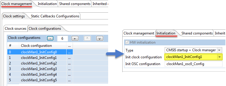

Just to complement on Vojtech Filip's good answer, you need to have predefined clock configurations and then select one of them for initialization in Processor Expert.
Below is an example of the configurations you get when creating a project for FRDM-K64F. In this case there are 6 predefined clock configurations from which Configuration 1 is selected for initialization:
Also your configurations will be available in the generated file clockMan1.h (default name) for you to use them using the system layer API CLOCK_SYS_SetConfiguration().
