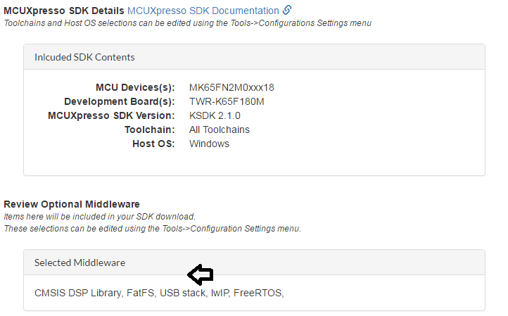

I requested the SDK version 2.1 for MK65. When I downloaded and installed it , I did not see the USB stack folder.
the release note shows that the USB demo should  within the folder <install_dir>/boards/<board_name>/usb_examples, but I even don't see that folder.
Did I miss anything when I request it?
Thank you,
Weining

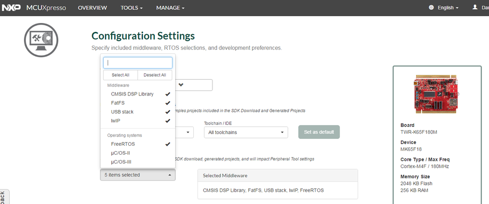

Hi Weining:
Please make sure usb stack middle is selected when you download SDK.

Hi Daniel,
Thanks a lot for your help. I really appreciate it.
Today I re-configure and download the SDK again, the SDK package includes the USB stack.  it seems that when i selected the Middleware, the USB stack is one of the "Must have" options, I even cannot un-check it from the list. Don't understand why the SDK I downloaded yesterday does not include the USB stack.
