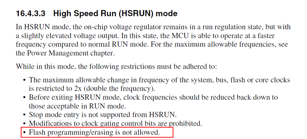

I have a TWR-KV58F220M board and I'm working on flash update routines.
If I use the default BOARD_BootClockRUN() routine at startup I am able to run the pflash demo code with no problems.  If I use a customized BOARD_BootClockHSRUN() routine I get a kStatus_FLASH_AccessError when I attempt to erase a flash sector.  The two clock initialization routines are shown below.  In both cases my bus/flash clock should be running at 25 MHz.  Any thoughts?

Hello Michael,
In the HSRUN mode , the Flash programming/erasing is not allowed .
Hope it helps

Thank you, I completely missed this in the reference manual.
For my processor the HSRUN mode supports CPU clock speeds up to 240 MHz and the RUN mode is limited to 160 MHz.  I would like to take advantage of the higher clock speeds for normal operation.  If I dynamically switch between HSRUN and RUN modes when I need to update flash, will FreeRTOS adapt to the clock changes?

Hi Michael,
Sorry i know the FreeRTOS little, in my personal opinion, it can.
You can first create a simple project to have a try.
For example , first run FreeRTOS project at HSRUN mode , if yes , then change HSRUN mode to RUN .
