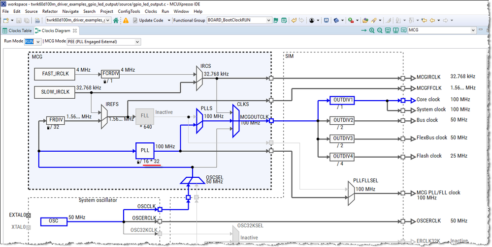

Please try to modify the PRDIV=16 and VDIV=32 manually. Then the SDK function will get clean 100MHz.
