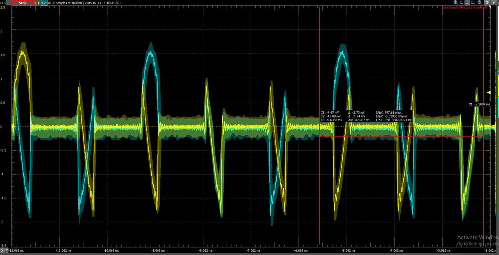

I'm trying to make this work with 2 TX channels but am having a hard time. I've replaced the fsl driver files with the ones attached to this thread and created 2 separate handlers for each TX channel but it still doesn't work.Capture.PNG
The closest thing I got to it working shown the result above (should have been a 1 kHz sine wave for each of the channels). I figured out that its only the first FIFO block is getting through, but further requests are being ignored until a new DMA transfer is submitted. I can easily make it work with one channel but ultimately the point is for these 2 channels to be working independently.
If you have any ideas about what may be happening, please let me know :smileyhappy:.
