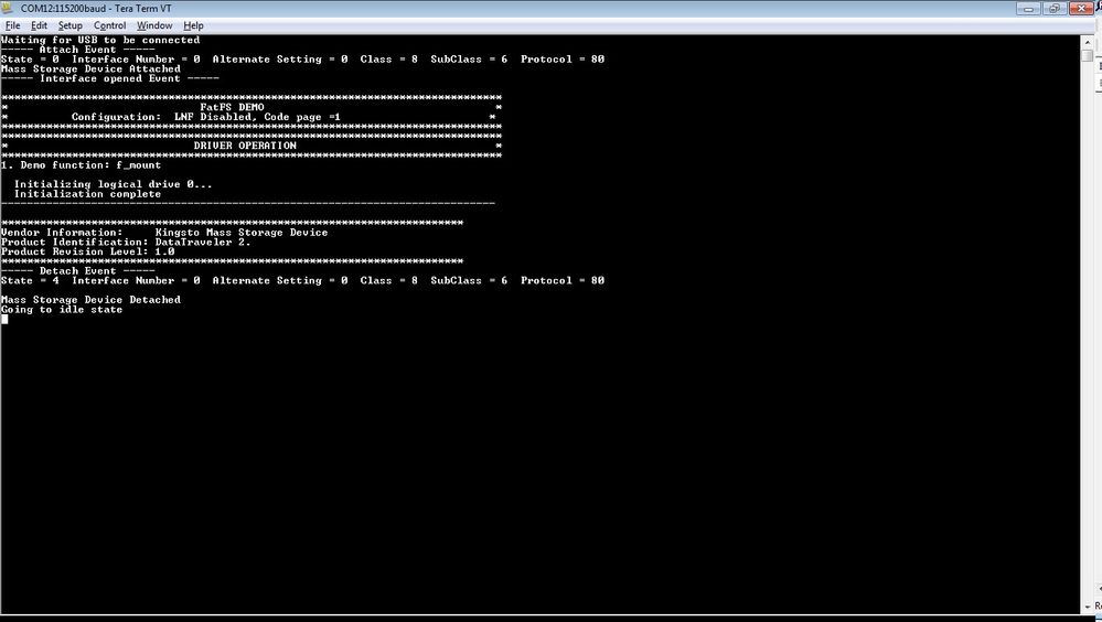

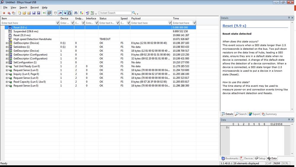

I could notice that there is a failure in your project when it tries to mount fatfs in the MSD, it seems to be a NULL pointer that would handle the information for attached device, then, host tries to detach the device and re-enumerate again but it does not matter how many times the device is enumerated, the problem is always shown.
I've created a basic USB Host + PEx + Fatfs 0.09 + KSDK 1.3 and BareMetal implementation example that seems to be working properly. Next image shows how the system is mounted correctly and some IOCTL functions are sent to device correctly.
USB Host + Fatfs 0.09 + PEx.jpgI hope this can help you!

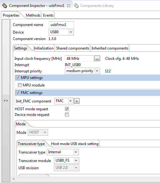

I see it is mandatory to flag both MPU and FMC settings in the PEx fsl_usb_framework component:
The usbFmw1_host_soc_init() function in the generated usbFmw1_host_bsp.c file automatically enables MPU clock gating and then disables MPU.
The USB task priority must be set to 4 (KHCI task priority is set to 3).
Also, the usbFmw1 component is set to be auto-initialized for convenience at startup. If after the startup my USB task deinitializes the USB Host driver and then re-initializes it (to see if the USB Host driver is well initialized and ready), then the USB Host driver does not work any more. So, I have to trust all the auto-initializations made at startup.
