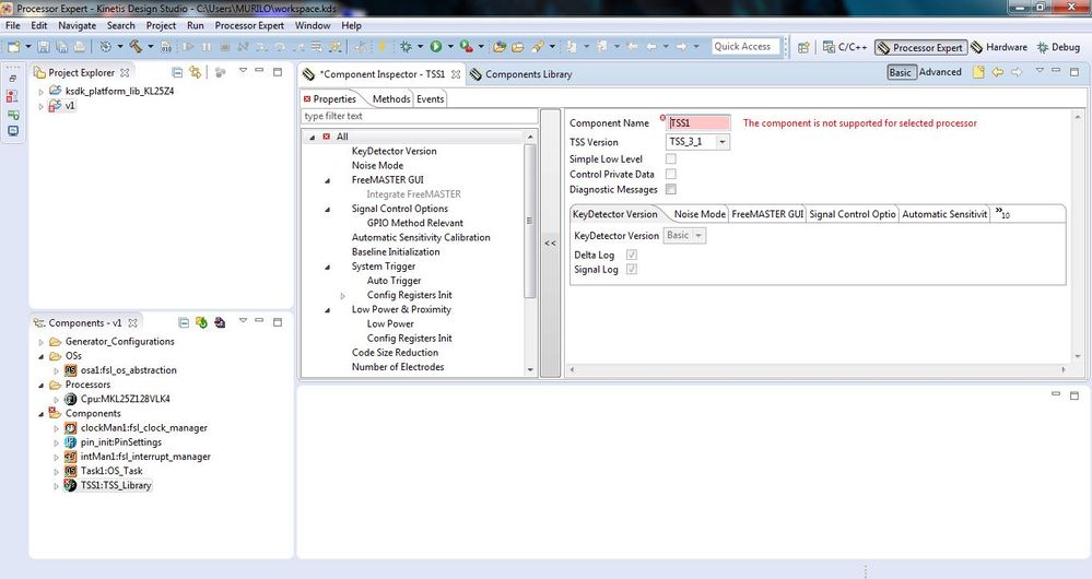

Hello. I am trying to use the capacitive touch slider on FRDM-KL25Z. Does anyone have any example or tip to use it with Processor Expert (SDK 1.2.0), because when I add the TSS component the KDS show me this error: "The component is not supported for selected processor".149383_149383.JPGCapturar.JPG

Hi Murilo,
that component indeed does not support the Kinetis SDK. If you want to use it, then you need to create/use a project without the Kinetis SDK.
Erich
