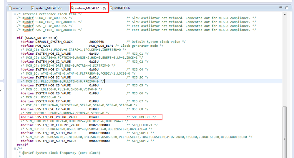

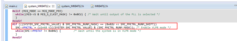

Hi Larry,
After you configuration the VLPR mode , you can find the code on the "SystemInit()" function, here:
the actual configuration code about the clock register is in the "system_MK64F12.h", here:
after you change your configuration of PE, you can find these are changed according your configrate.
Alice

Hi Larry,
Yes, i said above is the CPU component generated code .
Now,  let's do a comparison configurate to the CUP, then check the generate code, we will find the difference.
Below is configrate to  FEI mode,
Please compare these with my last reply screenshot, the last screenshot is configurarte to VLPR mode.
And that, you can configurate by yourself , then check the file I told you .
In a word , the code through change the macro of "system_MK64F.h" ( change the register in fact )  to change the CPU configuration.
Alice

Hi Larry,
The function of the "help on component " (such as SetClockConfiguration() ) is the function of PE, not KSDK.
We only can refer to it cofiguration the PE-KSDK .
And the clock related function is in the "fsl_clock_MK64F12" file.
After I configuration to VLPR mode, the genereted code is like this :
