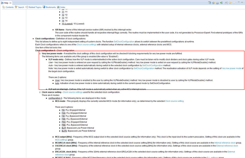

Hi Larry,

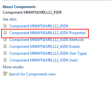

About the VLPR , you can configuration here :
And about the introduce of the configuration , you can refer to " right click the CPU component -> help on  component -> Component  xxxx MCUInit" , then you can find :
Hope it helps
Alice

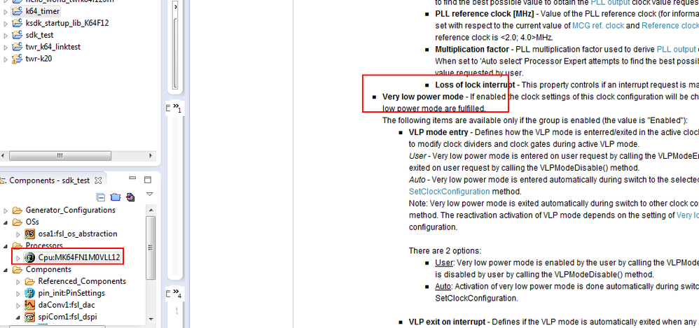

larrykoos
You must not be using the same tool version as I am. When I right click on the CPU component and follow the help screens, I get to the following screen that is similar, but not the same:
As I said in the original post, I'm using KDS 2.0.0 and MQX KDSK 1.1.0.
Also, while the help screen refers to SetClockConfiguration, there is no method with that name under the CPU component. There is one called CLOCK_SYS_setConfiguration under the clock manager component, but I don't see the connection between the clock configurations defined in the CPU component and the methods defined in the clock manager.

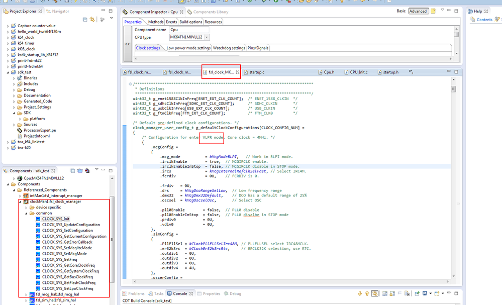

adriancano
As colleague Alice Yang mentioned the SetClockConfiguration() method is related to a just PEx project. When using a PEx + KSDK method the corresponding method is CLOCK_SYS_SetConfiguration. You can check an example about the power manager in the KSDK_1.1.0 installation folder following the path <install_folder>\KSDK_1.1.0\demos\power_manager_demo.
The example is not set with PEx expert but uses the KSDK drivers it will help you to understand how to use the power_manager driver.
Hope this information can help you.

larrykoos
Adrian and Alice,
Thanks for the responses.
As I said in an earlier reply, I am aware of the CLOCK_SYS_* functions in the Clock Manager Component. I am also aware of the clock configurations that Alice mentioned in her last reply. Unfortunately, I do not believe the ones she refers to are generated from the clock configurations tab in the CPU component. I believe they are just the default configurations built into the driver code. My question is:
Does the PeX+KDSK tool generate a table of clock configurations from the CPU component and where in the Generated_Code directory can this table be found?
I don't think the tool generates this table.

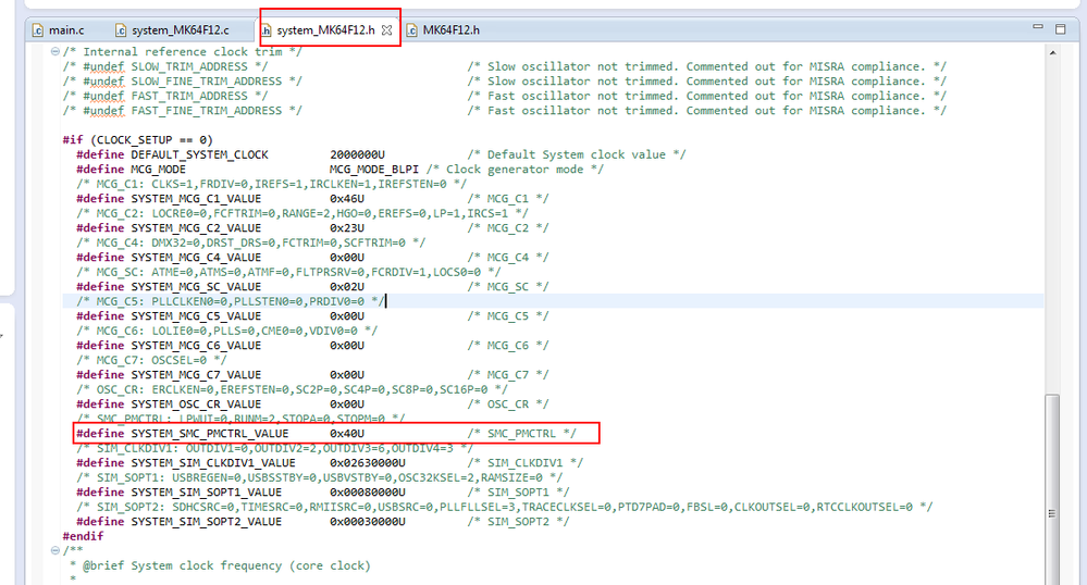

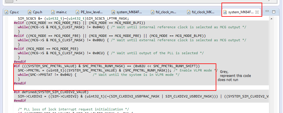

Hi Larry,
After you configuration the VLPR mode , you can find the code on the "SystemInit()" function, here:
the actual configuration code about the clock register is in the "system_MK64F12.h", here:
after you change your configuration of PE, you can find these are changed according your configrate.
Alice

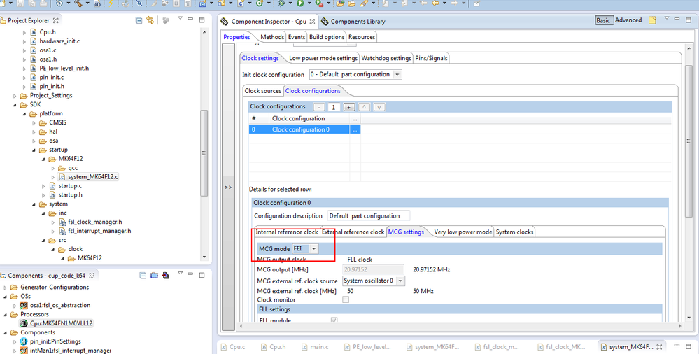

Hi Larry,
Yes, i said above is the CPU component generated code .
Now,  let's do a comparison configurate to the CUP, then check the generate code, we will find the difference.
Below is configrate to  FEI mode,
Please compare these with my last reply screenshot, the last screenshot is configurarte to VLPR mode.
And that, you can configurate by yourself , then check the file I told you .
In a word , the code through change the macro of "system_MK64F.h" ( change the register in fact )  to change the CPU configuration.
Alice

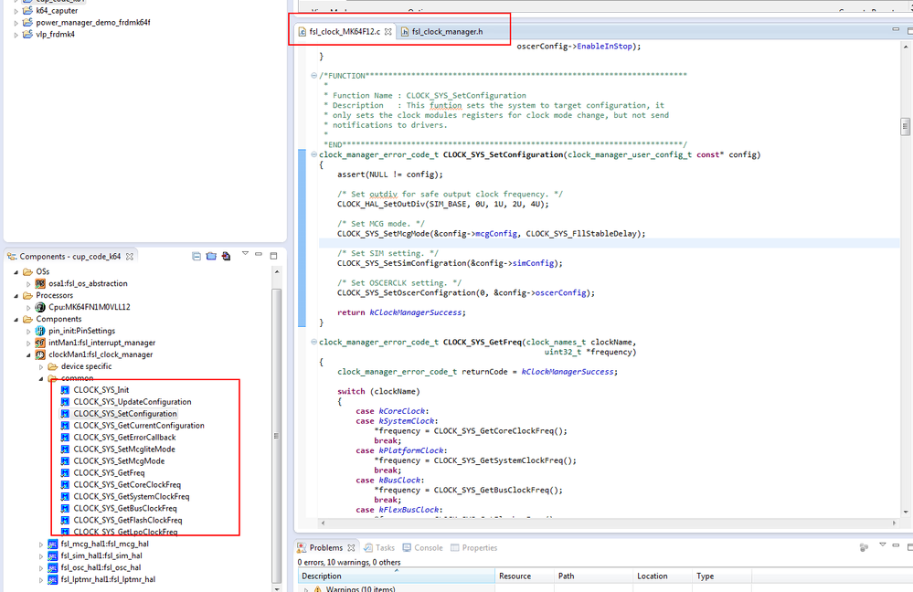

Hi Larry,
The function of the "help on component " (such as SetClockConfiguration() ) is the function of PE, not KSDK.
We only can refer to it cofiguration the PE-KSDK .
And the clock related function is in the "fsl_clock_MK64F12" file.
After I configuration to VLPR mode, the genereted code is like this :
Best Regards
Alice
