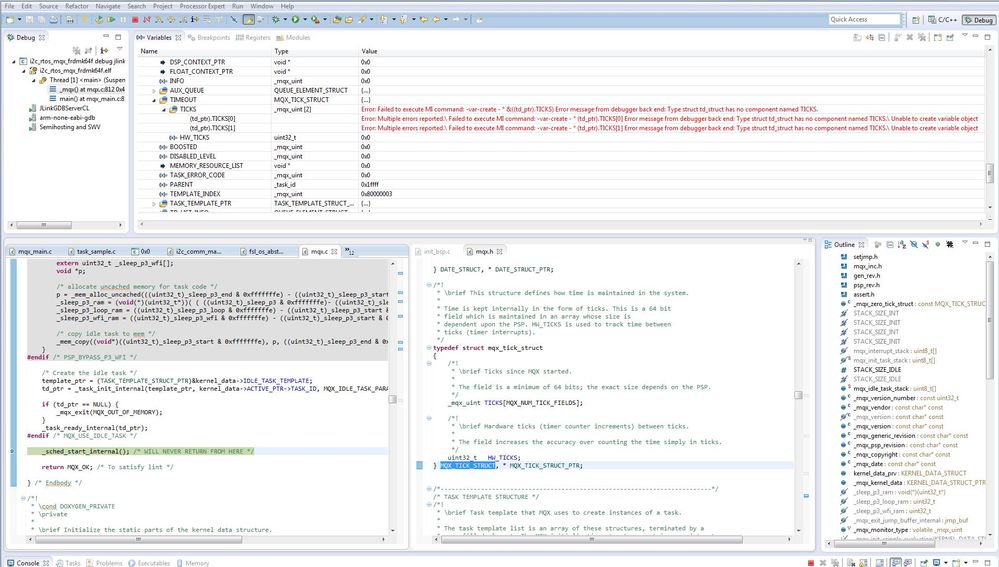

yorknh
Iva,
I've narrowed it down some, though I don't really know what to make of it. There appears to be something wrong with the td_ptr. I've stepped through the _mqx function and the debugger display errors associated with the TIMEOUT structure within td_ptr. I've attached a screenshot.td_ptr.JPG.jpg
When _time_delay gets called, the TIMEOUT displays the same errors so it is hard to know what is happening.
