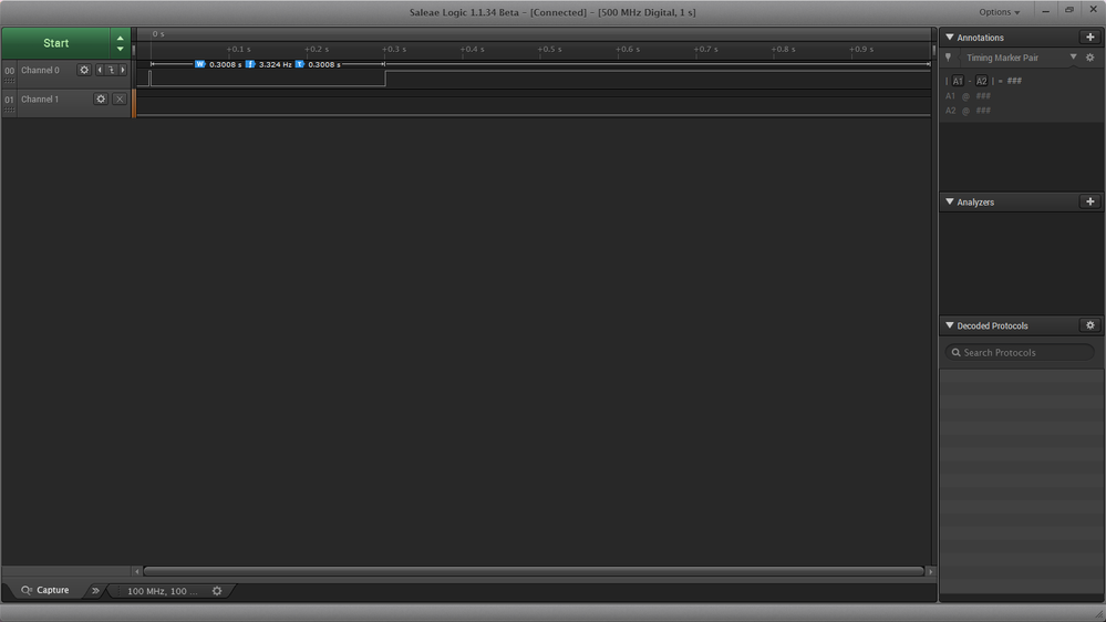

I have focused on i2c_rtos_mqx_frdmk64f and make some modifications with OSA_TimeDelay() and made screenshot for you.
When I set OSA_TimeDelay(200) in task_master(task_param_t param)
I got the correct output
When I set OSA_TimeDelay(300) I also get correct output
Iva
