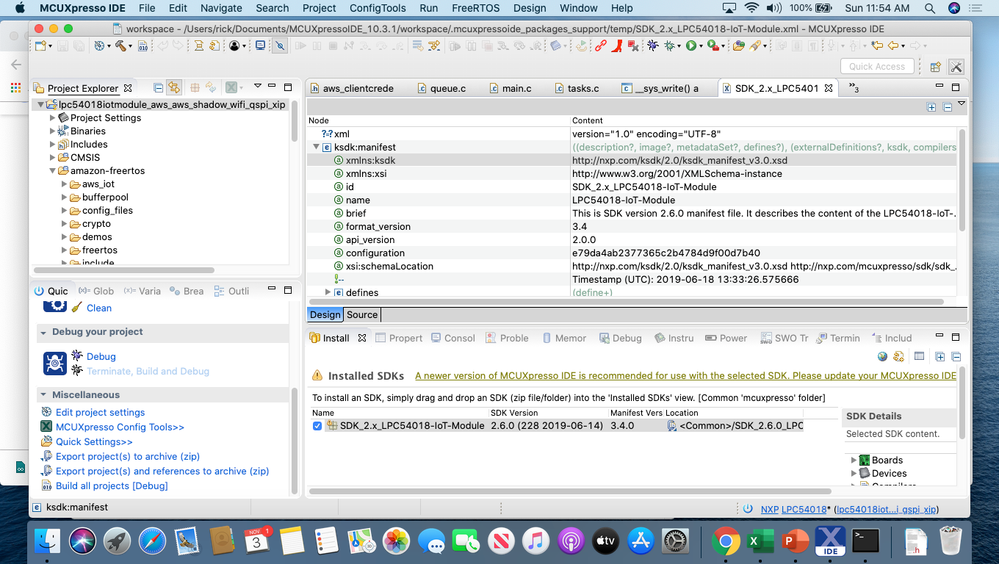

The SDK is :
The IDE is :
MCUXpresso IDE v10.3.1 [Build 2233] [2019-02-20]
