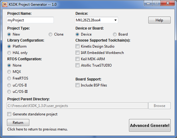

Features mentioned in Release Note:
The following features are available with the KSDK Project Generator 1.0 GA tool:
  • Cross platform
    • Operates on Windows, Linux, and Mac OSX
    • Developed in 32-bit Python 2.7 on Windows 7, Ubuntu 14.10, OSX 10.10 & 10.11
  • Supports KSDK 2.0, KSDK 1.3.0 and 1.2.0 (and is needed to install KSDK 1.2/KSDK 1.3)

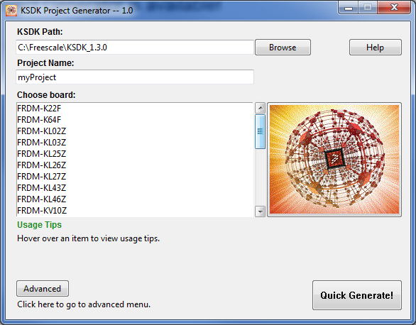

  • Quick Generate of development board based KSDK projects
  • Advanced Generate of New KSDK based projects
    • Device or development board based
    • Linked to KSDK installation or standalone
    • RTOS support
    • HAL or Platform library level projects
    • Libraries in standalone projects tailored to device package
    • KDS, IAR EWARM, Keil MDK, and/or Atollic TrueSTUDIO IDE projects
  • Advanced Generate of KSDK ‘demo_apps’ Clones
    • Clone projects located in ‘demo_apps’ folders for each development board
    • Linked to KSDK installation or standalone clones

I seem to have found a bug. With this configuration, the project keeps generating forever, continually filling and clearing the progress bar. It creates the myProject directory but no files have been placed there.
Also, if I choose a generated 2.0 SDK, only the KDS toolchain shows up as an option (didn't see this obvious known issue in the Release Notes).
Lack of USB code generation and no pin mapping utility is a problem as well. Finally, a Users Guide is badly needed, even with the lack of features. This software doesn't seem to have any real value at this point. I think this version is too premature to have been released. When is the next planned update?
Hi Paul,
If my understanding is correct, I can´t confirm this bug on my side.
I tested with your configuration and it works without problems. Generating process successful finished and in folder are placed all needed files.
Please see the attached video.
To your second point, it depends, what tool chain did you select when you download the KSDK 2.0. So if you selected KDS, you will see KDS.
With USB Stack - it is a good point, there is only option for cloning demo_apps examples and is not possible to add USB Stack to your code using this tool.
I will ask about this option for future release and let you know.
