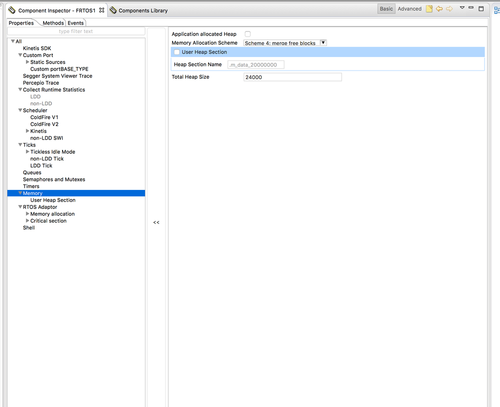

jacobjennings
You may also consider using one of the heap implementations provided by freertos (particularly heap_4). Another tip is to use the FreeRTOS PX component published by MCUOnEclipse which allows for heap configuration via the component inspector like this:
McuOnEclipse - Browse /PEx Components at SourceForge.net
https://mcuoneclipse.com/2015/07/08/tutorial-using-processor-expert-and-freertos-with-kinetis-sdk-v1...
6,460 Views
MAPC
Senior Contributor I
Thank you very much, Jacob!
Fantastic support! I tested your example and it is working fine now!
