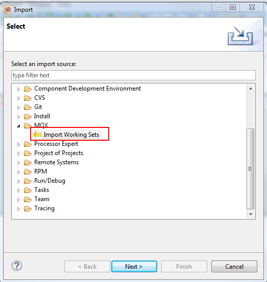

ivadorazinova
Hi Allyson,
I apologize for my late response.
Yes, exactly as Alice described. I also write about this at How to: import example in KSDK
Just a question, did you build the package as standalone from kex.freescale.com or from mainline package KSDK1.3 by the same way for demo hello_world?
I´m attaching you the video with the procedure.
Please, let us know if this helps you!
Iva

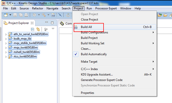

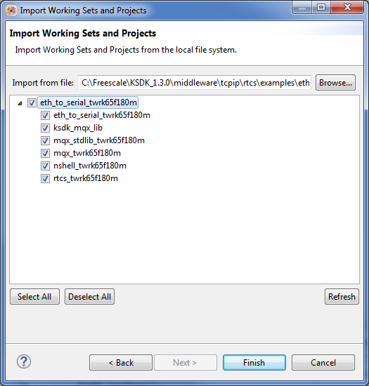

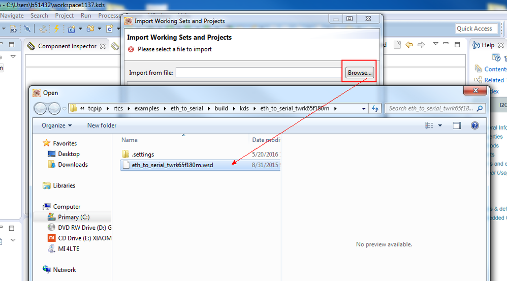

Hello Allyson,
Have you problem be resolved ?
If not , please use th "Import Working Sets" button to import the project :
I now show your the screenshot about how to do step by step :
The path is :KSDK_1.3.0\middleware\tcpip\rtcs\examples\eth_to_serial\build\kds\eth_to_serial_twrk65f180m
Then build all :
After build , if still have error, please delete your KDSK1.3,  then re- install again.
If still can not used , please re-install the KDS .
Hope it helps
Alice

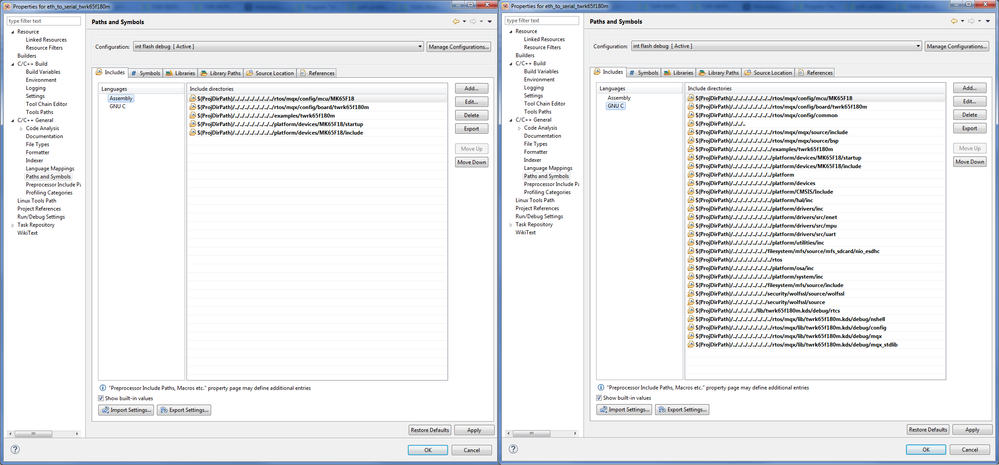

ivadorazinova
Hi Allyson,
Please, what KDS do you use?
What do you use for debugger?
Please can you check these paths for your project?
Iva

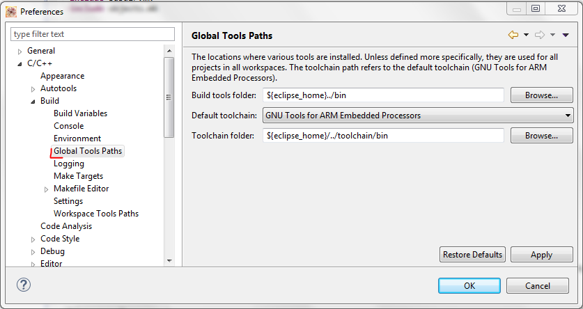

michalzan
And what about Workspace Tools Path? Is it empty?
8,576 Views
allysonward33
Yes it is empty. Should something be there?
8,577 Views
michalzan
Hi Allyson,
Could you please check your Window->Preferences->C/C++->Build->Global Tools Path if you have it set accordingly?
If so, could you please check if you have the make.exe inside folder {KDS Install folder}\bin\
There should be all the following files:
Hope this helps, let me now.

allysonward33
I have the preferences and the make.exe in the locations you listed.
