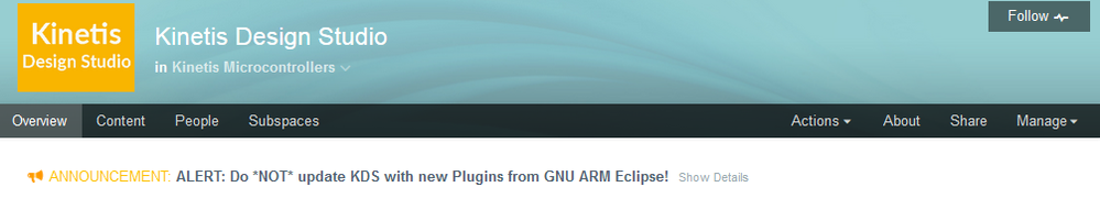

ivadorazinova
Hi Loic,
yes, there is an error with the J-Link.
Please,
  1. Close KDS/Eclipse
  2. Download the attached 'plugins.zip'
  3. Extract the two plugins in that zip file to the 'plugins' subfolder of your installation folder (C:\freescale\kds_v3.0.0\eclipse\plugins)
  4. Confirm to replace the original files
  5. Restart KDS/Eclipse. Segger J-Link debugging is possible again.
The workaround is described also here Unable to Debug after KDS Update
We have also alert to avoid this.
Thank you for your understanding,
Iva
