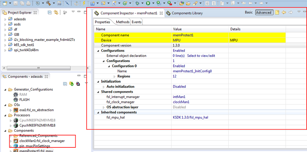

I have a project for the TWR-K65F180M board. After upgrading the project from KSDK 1.2.0 to 1.3.0 I am getting an error on the fsl_mpu component:
Any help on solving this?

Hello  ,
Could you please send you project to me , i will check it on my side .
And i create one new simple project on my side , KDS3.0 + SDK1.3, after add the component of "fsl_mpu" , there is no error :

jesperpape
Yes, I can create a new project also without problems. The problem is upgrading from KSDK 1.2.0 to 1.3.0. The problem can be easily recreated by creating a new project using KDSK 1.2.0 and then upgrading it to KDSK 1.3.0. I use MQX standard configuration in the osa1 component. I'm attaching the small KDS project where the problem is recreated - before and after upgrading.

Hello Jesper,
Sorry for that the KSDK1.2 project can not porting to KSDK1.3 , they are much different , only can create a new project .

jesperpape
Hello Alice,
Not so great...
But I found out it is possible to upgrade the project by temporarily setting the OS to "Bare Metal" in the osa component. After the upgrade I set it back to "MQX".
