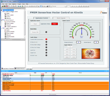

Real Time Monitor
-Displaying variable values in various formats (Text, Real-Time waveforms, High-speed recorded data)
Control Panel
- Direct variable value settings and variable stimulation, scribtable in JScript or VBScript
Demonstration Platform
- Demostration embedded app by HTML pages, display simultaneous real-time data monitoring

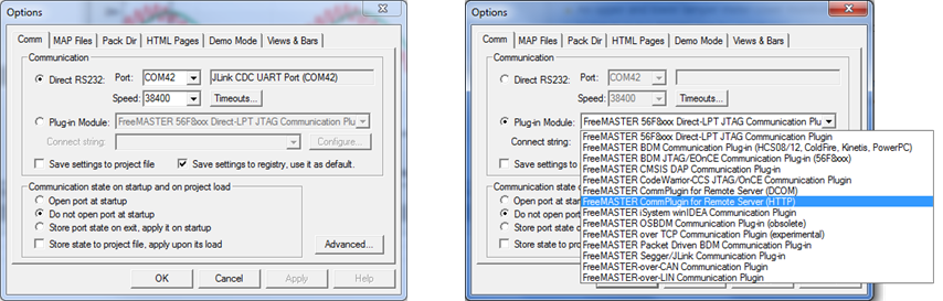

FreeMASTER communication
There are two types of communication. It is possible to communicate via Direct RS232 or selected Plug-in Module.
In short:
SCI, UART
USB – CDC – Kinetis, ColdFire V2
CAN
JTAG (56F8xxx only)
BDM – Kinetis, PowerPC, ColdFire, HCS with Segger, P&E Micro, CMSIS-DAP…

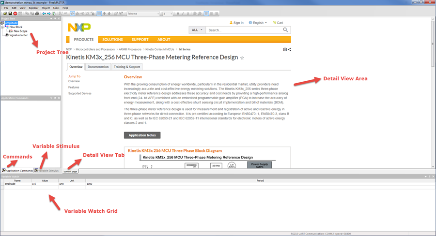

FreeMASTER description of the environment
The FreeMASTER window is divided into 4 parts - Project Tree, Detail View Pane, Commands and Variable Watch Grid.
Project Tree is the project, New Block is a root of the project, New Scope is similar to classical Oscilloscope. Scope periodically reads variable values and plots them in real-time. It is limited by the serial communication speed. The recorder is also monitoring and visualising variable values, but the change is much faster. The recorder is running on target board and variable values are sampled into memory buffer on the board and then these sampled data are downloaded from the board to FreeMASTER.
Detail View Area is dynamically changes depending on content which is selected in Project Tree. Detail View Tab can be control page, algorithm block description, scope, recorder or another HTML document whose URL is defined in the Scope or Recorder properties.
Commands window is list of commands to send, Variable Stimulus - is the list of defined variables for the defined time.
In Variable Watch Grid contains the list of watched variables.

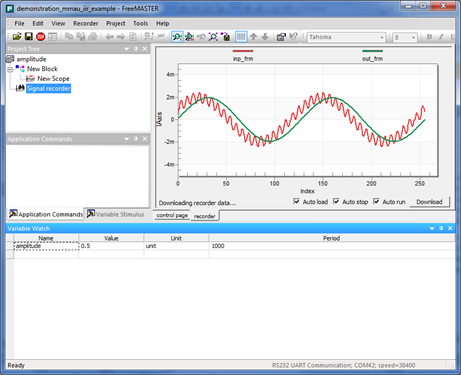

Is there any possibility in freeMaster GUI to save the oscilloscope data and re-load it at a later date? (e.g. offline analysis)
I only find option to export an image file.
Or do I miss something?
Yes, you can save the data captured by oscilloscope/recorder. There is a settings "Data Capture Setup" where you can specify the file the data is saved into:
Hope it helps.
Stan
I tried that, but it does not work.
The files are always generated at C:\Users\xxxx\AppData\Local\Temp instead of the path provided here.
Am using Windows 10 and and latest version of freeMaster.
