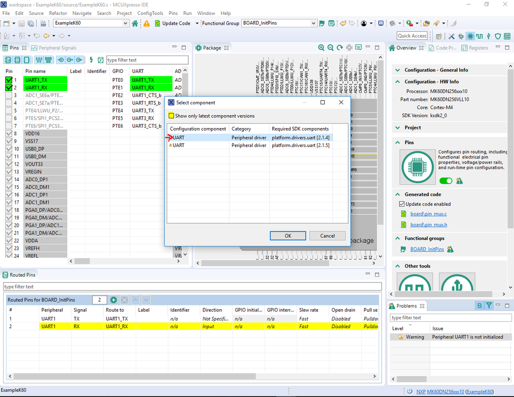

Where can I get the latest version (2.1.5) of UART driver for Kinetis K60?
With MCUXpresso (MCUXpresso IDE v11.0.0 as well as the previous version) and Kinetis SDK (Release Name: MCUXpresso Software Development Kit (SDK) Release Version: 2.2.0)
I get a warning during code generation for UART in MCUXpresso: "Unsupported version of UART driver in the toolchain/IDE. Required 2.1.5/actual: 2.1.4."
It seems the SDK has version 2.1.4. So, where can I get version 2.1.5?
Satish

Following are the steps to recreate the warning message:
- Bring up MCUXpresso v11. I had dragged the latest SDK zip file into the MCUXpresso previously.
- Create a new project.
- Select MCU as K6x --> MK60DN256xxx10.
- Select SDK Debug Console as Semihost.
- Select All Drivers (just to simplify)
- Select Redirect printf/scanf to ITM
- Link application to RAM
- In Pins Config Tool, configure Pin 1 as UART1_TX and Pin 2 as UART_RX.
- In Problems window, a warning "Peripheral UART1 is not initialized" shows up.
- Right click on the message as select "Initialize UART peripheral". Window pops up showing UART component as required SDK component as "platfom.drivers.uart[2.1.5]". Looks like it is expecting 2.1.5 version.
Select OK.
- Now, another warning pops up in Problems window, "Unsupported version of UART driver in the toolchain/IDE. Required 2.1.5/actual: 2.1.4"
Inside the SDK, I do see uart revision as 2.1.4 in the manifest.xml file.

Sabina_Bruce
Hi Satish,
   Thank you for providing the details, I was now able to reproduce the same warnings and consequently errors when building the project. I believe this is a bug concerning the config tools. I have reported this and will get back to you as soon as I get information on how to fix this.
   In the meantime can you try  this to see if this solves the issue for now. I was able to remove any errors when building the same project by doing the following. When you right click the warning to initialize the UART module, I unchecked the box that states "Show only the latest component versions". This now showed two options I click the earlier version of the UART 2.1.4, pressed ok. Now I have no errors or warning and when I built the project I also did not get any further errors.

tbiberdorf
Hi Sabirna
I attempted this right click of the warning, but I cannot get my system to open the window that you indicate.  Can you provide any further detailed instructions?
Terry
4,493 Views
tbiberdorf
I created a new workspace and things started to work.
