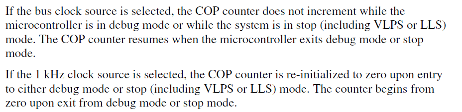

I´m making some tests and as I can see looks like watchdog stop to run when I enter in LLS mode.
Is that right or I´m doing something wrong?
my configuration is
 const wdog_config_t watchdog1_InitConfig0 = {   .wdogEnable = true,   .clksrc=kWdogLpoClkSrc,   .prescaler = kWdogClkPrescalerDivide1,   .workMode.kWdogEnableInWaitMode = true,   .workMode.kWdogEnableInStopMode = true,   .workMode.kWdogEnableInDebugMode = false,   .updateEnable = true,   .intEnable = false,   .winEnable = false,   .windowValue = 0U,   .timeoutValue = 2048U, };
thanks

Hello  Vioder,
No,  when the K64 chip in LLS mode , the WDOG will not work .
Please see here at your RM:
Hope it helps
Alice

Hello Voider,
Yes , you are right ,
the COP counter does not increment while the
microcontroller is in debug mode or while the system is in stop (including VLPS or LLS)
mode.
Which chip do you used ?
You can check the Reference manual of your chip , for example the chip of  KL25 ,
from the reference manual , the part of this :
3.4.10 Computer Operating Properly (COP) Watchdog
Configuration
Hope it helps
Alice Yang

voider
Thanks for your quick reply.
I´m using K64 processor and the manual where I´m trying to find some information is:
Document Number: K64P144M120SF5RM Rev. 2, January 2014
The information that I found is that I can use LPO and LPO stay active in LLS mode, so I think watchdog will stay active also.
And In 24.3.36 says that watchdog still run in stop but take twice as expected time to fire.
5.7.1 PMC 1-kHz LPO clock
The Power Management Controller (PMC) generates a 1-kHz clock that is enabled in all
modes of operation, including all low power modes. This 1-kHz source is commonly
referred to as LPO clock or 1-kHz LPO clock.
Table 7-2. Module operation in low power modes (continued)
Modules Stop VLPR VLPW VLPS LLS VLLSx
1kHz LPO ON ON ON ON ON ON in VLLS1/2/3, OFF in VLLS0
24.3.6 Low-power modes of operation
Stop Where the bus clock is gated, the WDOG can run only on low-power oscillator clock
(CLK_SRC=0) if it is enabled in stop (STOP_EN=1). In this case, the WDOG runs to time-out
twice, and then generates a reset from its backup circuitry. Therefore, if you program the
watchdog to time-out after 100 ms and then enter such a stop mode, the reset will occur after
200 ms. Also, in this case, no interrupt will be generated irrespective of the value of
IRQ_RST_EN bit. After WDOG reset, the WDOG reset counter will also not increment.
I do not found anything about LLS.
Do you think watchdog in K64 will not work in LLS  like KL25 ?
Thank you

Hello  Vioder,
Hope it helps
Alice
