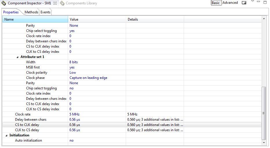

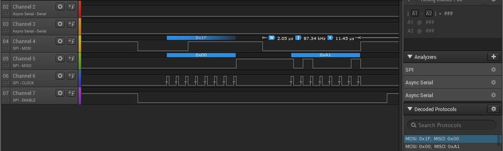

attached is the screen shot below where the read is working properly and the config follows
I am trying to communicate to MAX3107 IC with CPOL =0 and CPHA = 0 at 5MHz

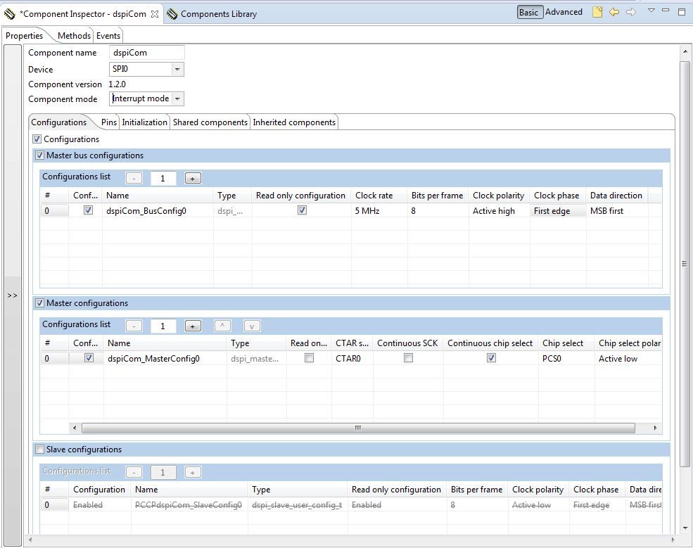

While I am working with KSDK 1.2.0 and KDS 3.0 , I have done a similar Master configuration on my side. I am unable to recieve any data by doing
if(kStatus_DSPI_Success == DSPI_DRV_MasterTransferBlocking(FSL_PCCPDSPICOM,
                                                                   &PCCPdspiCom_BusConfig0,
                                                                   tx_buff,rx_buff,
                                                                   no_of_bytes+1,1000))

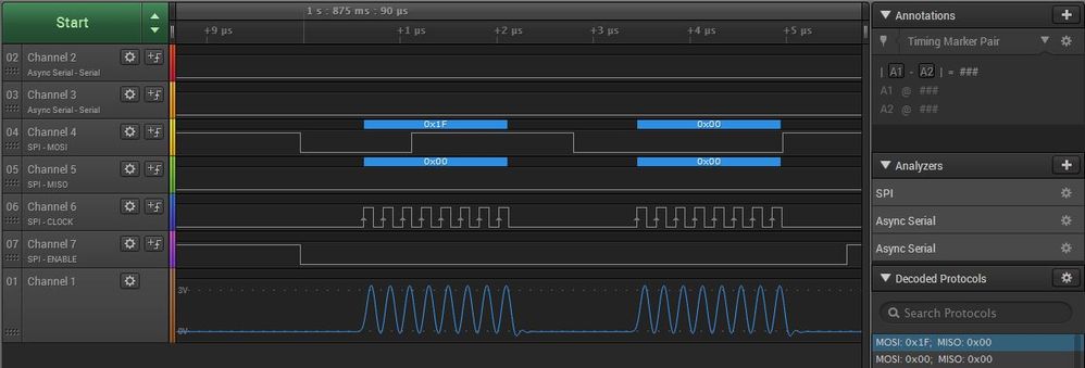

I am able to see that the data is successfully written on MOSI  but there is no response on MISO, i just tried to see if there is any glitch on clock with 50MSPS(maybe i need a better sampling rate to see the glitch here, otherwise also i pulling it low)
the configuration follows.
is there anything which I am suppose to do but I am missing with configuration.

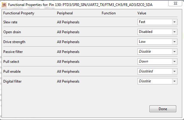

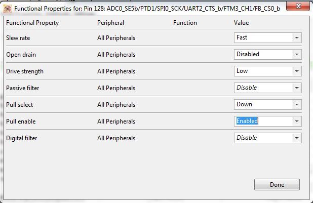

While my pin settings are as below with drive strength high (Drive strength Low will be a thing to try from a suggestion from another thread)
For SDI, SDO, PCS
For SCLK below settings with pull down

If I understood correctly, you are able to receive data when using PDD component but you are not, when using KSDK and PEx support, aren't you?
If so, I would recommend you to check any differences between SPI registers in both projects (mainly in CTAR register, that configures some delays and other settings for the transfer). I suggested this because what i could find in your images, both signals are almost the same, but probably there are difference for example in duty cycle in CLK signal or other timing that is configurable for DSPI module.
