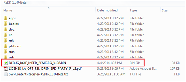

Debugging with P&E Micro Interface:
To debug using the P&E Micro interface, the P&E Micro OpenSDAv2 app needs to be loaded onto the OpenSDAv2 circuit. Instructions for loading and using this app are in Appendix C of the Getting Started with KSDK Guide. Use the DEBUG_K64F_MBED_PEMICRO_V108.BIN file that came inside the Kinetis SDK zip file.
If you want to return to the original CMSIS-DAP/mbed interface, you can find a binary app to drag-and-drop onto the OpenSDAv2 bootloader on the FRDM-K64F mbed page. Firmware FRDM K64F - Handbook | mbed

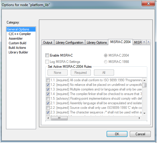

When compiling the Kinetis SDK platform library in IAR 7.10.x, I the following error messages: Error[Pm056]: all if, else if constructs should contain a final else clause (MISRA C 2004 rule 14.10):
This is caused by a MISRA C 2004 rule violation. The beta Kinetis SDK was built using IAR 6.70, but the MISRA C checks were changed when IAR moved to 7.10.x which is why this comes up in IAR 7.10.x.
This error can be fixed by disabling MISRA C checking in the project settings.
Right click on the platform_lib project, and under the General Options category, scroll over (using the arrow keys on the right) to the MISRA-C-2004 tab, and uncheck “Enable MISRA-C”.
