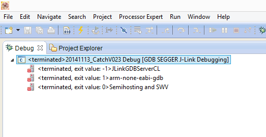

I was having no trouble with KDS/KDSK in terms of compiling and now it's being touchy, running less and less consistently now to a point where I can't get my application on to the chip, and if I open terminal I'm seeing the last program that was loaded onto it running. I tried unplugging, holding reset while plugging back in and reloading OPENSDA 2.1 multiple times, and while the board automatically resets and appears as the J-Link under COM Ports, it won't load code. It won't even load a file with just while(1) or for(;;) and no code, no includes other than things like studio.h, etc...it will however load example projects. I don't understand this inconsistency - I had this working for almost a month and in the last 24 hours it started to do this.

Could it be that bug in GDB?
http://mcuoneclipse.com/2014/10/11/failed-to-debug-with-gdb-breakpoints-or-expressions-on-non-existi...
Clear all breakpoints and watchpoints/expressions.

I just tried clearing all breakpoints - noticed that there were two BP's on the same line of code as well - and that appears to be exactly what it is...I hope. I'm back to running so I'll keep this in mind, and thank you for the quick response. Now if I could only get SAI to work properly, I'd be really happy.:smileysilly:
