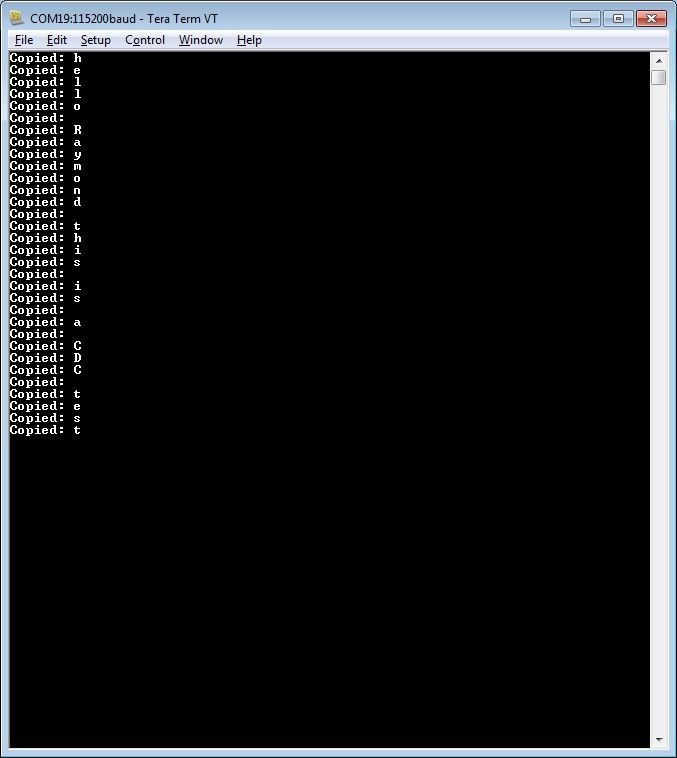

isaacavila
Hello Raymond,
In CDC example, USB_Class_CDC_Send_Data function serves as sending host ack package as well as makes the looback function.
In your case, you need to send a NULL package only when data has been received (ACK package), try something like this:
void Virtual_Com_App(void) {
     if ((0 != g_recv_size) && (0xFFFFFFFF != g_recv_size))
        int32_t i;
        /* Copy Buffer to Send Buff */
        for (i = 0; i < g_recv_size; i++)
            USB_PRINTF("Copied: %c\n\r", g_curr_recv_buf[i]);
        g_recv_size = 0;
        /* Send NULL data when package has been received */
        USB_Class_CDC_Send_Data(g_app_handle, DIC_BULK_IN_ENDPOINT,
                    NULL, 0);
Other way, every time that Virtual_Com_app is called, you are trying to send a NULL data making endpoint to be busy and crashing application.
I made a simple test of this function and it seems to work fine (next image shows what i got on UART terminal (OpenSDA terminal)).
I hope this can help
Isaac

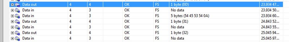

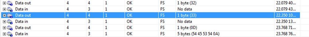

isaacavila
Hello Raymond,
After a review on your code, i noticed that you are sending NULL package on every received data and then, once you received '\r' character, you try to send a string ("TEST"). Current demo structure needs to send NULL data only when there is not available data on device, otherwise, you should send these data to host.
For example, your current project sends both data (NULL and string):
As you can see, when device receives 0x0D, you send a NULL package (No data) and then send 5 bytes ("T E S T \0") bytes, this causes xD to get full after 9 attempts.
The right way to do this would be only send NULL package when you do not want to send data to host:
As you can see, after 0x0D is received, we send the string ("TEST") instead of NULL data and this works fine, otherwise, we send NULL data. Next is code used to get this functionality:

In Virtual_Com_App, signal when data has been received.
    int c;
    int received = 0;
    /* User Code */
        int32_t i;
            usb_if_vcom_put(g_curr_recv_buf[i]);
        g_recv_size = 0;
        /* This flag serves to send NULL package or data package */
        received = 1;
        /* This flag inform about a receive event, trigger next request */
        received_data = TRUE;
    g_send_size = 0;
    while ((c = usb_if_vcom_get()) != -1)
      g_curr_send_buf[g_send_size++] = c;

raymondwhite
Hello Isaac
Sorry for being obtuse.
I understand your explanation, but I think it misses the point. The code I provided was a contrived example that I put together to illustrate the problem I am seeing.
The way you have coded it assumes that a '\r' will always result in data being sent to the PC. While that is true for the example program I provided, the reality of the situation is that I need the VCOM port to behave truly asynchronously in the send and receive directions.
Consider the case where I could program a timer to wake up and send the "TEST" string at random intervals instead of tying it to the reception of '\r', then when a character is received there may be no characters in the send buffer, so it will send a NULL.... but, a tiny fraction of a second later, the timer could wake up and insert characters into the send buffer. This would result in in the same pair of DATA IN messages in your first table, hence the loss of an xd entry. Such a program would take much longer to exhibit the failure, but it would eventually fail.
-Ray
