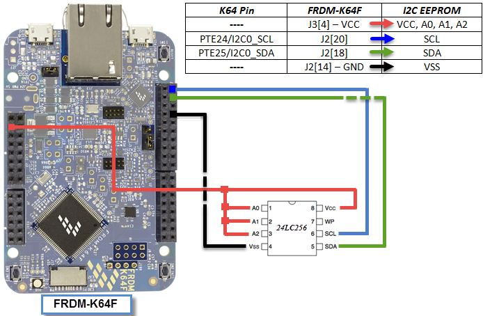

I wanted to share an example project developed with KSDK v1.0.0 and KDS v1.1.1, which uses a simple driver to communicate to an I2C EEPROM memory using a FRDM-K64F board. The driver is focused and was tested with a 256 Kbit memory (24xx256), but it should be compatible with the 64Kbit, 128 Kbit, 256 Kbit and 512 Kbit versions. This demo project demonstrates how to use the APIs of the KSDK I2C Master Driver.
The connections are as next:
Please notice this is not intended to be a robust driver for I2C EEPROMs. Instead consider it a basic demo code, but with time we could improve it.

Just one small technical note: Prior we start with EEPROM connecting we have to check schematic revision of our FRDM-K64F board. Old boards with schematic version older than version D1 had swapped SCL&SDA signals. More details here:
http://www.freescale.com/files/32bit/doc/errata/FRDMK64F_ERRATA.pdf

Hello Paulo Montanher:
The address is defined with the macro "EEPROM_ADDRESS" in the file I2C_EEPROM.h. This address is used in the structure eeprom from the file I2C_EEPROM.c, together with the baudrate. This structure is used to call the KSDK I2C driver APIs.
Just notice the address is right justified and the driver takes care of shifting the address 1-bit to the left.
Regards!
Jorge Gonzalez
