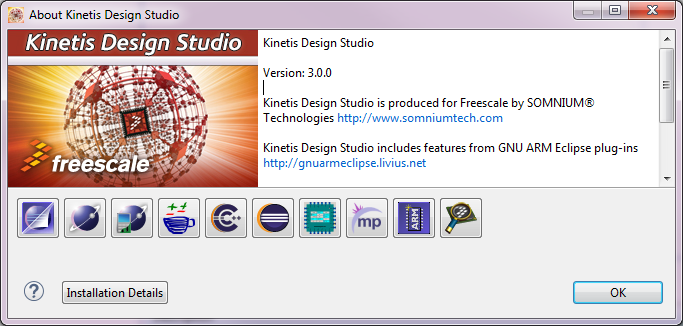

it does not seem to be problem of the demo. It looks on problem with your KDS settings.
Can you execute other demo? Or it is just problem of this demo?
Just control question -
  • do you really execute KDS 3.0 IDE? (Help -> About Kinetis Design Studio)
  • have you installed the eclipse update?
  • do you use new workspace for KDS 3.0 ?
It could be problem when you moved from KDS 2.0 to KDS 3.0 and could be problem with the workspace and data migration.
We can check it easy. If you go to File -> New -> Kinetis Project in KDS 3.0
type name of project, look at the location - do you use new workspace for new KDS? or do you have the same workspace like for KDS 2.0?
and the second point, please, look at supported boards. Do you have the same boards as me?
I hope this helps,
