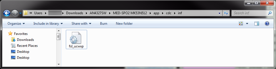

Hello everyone. I connected usb cable to TWR-SER same Pulse Oximeter AN4327. But my PC didn't recognize it as virtual com port. My pc recognized it as "FREESCALE SEMICONDUCER INC." so that I can't run project.

Hello Pham Minh Thuan,
please, have you installed the driver for the Virtual Com Port?

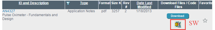

The driver is located in the project folder.
It is .inf file located at AN4327SW\MED-SPO2 MK53N512\app\cdc\inf
I hope this helps,
