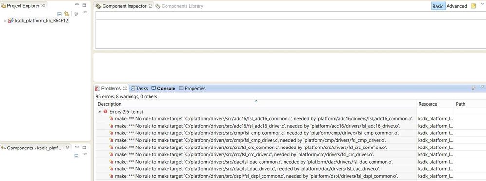

I'm attempting to move to KSDK 1.1.0 (from 1.0.0).
I uninstalled old version of both KSDK and KDS 2.0.0.
Reinstalled KDS 2.0.0
Installed KSDK 1.1.0
Imported KSDK Software into KDS (per "Getting Started" .pdf)
Imported the appropriate library (per "Getting Started" )
Attempted to build the debug configuration of the library and got 95 errors.
What am I missing?

Thanks for the reply David.  KSDK_PATH is correct. I believe this was automatic since I started with a clean installation.
But I did find this:
No Rule to Make Target in KDS
It points out that when importing a library, you have to un-check "Copy projects into workspace". If you copy the files into the workspace, the links to other modules don't work.
Having done that, I'm in good shape.
