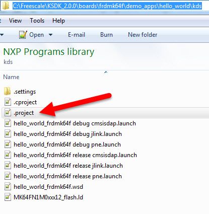

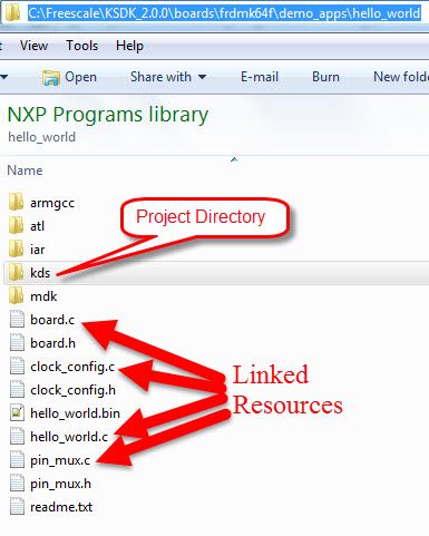

If cleaning the project doesn't help, then the likely cause is an issue with a linked resource.  These toolchains use the Eclipse open-source IDE, and Eclipse manages some files in a project as linked resources.  With an Eclipse project, the project directory is the directory that includes the .project folder for Eclipse.  For example, in KSDK v2.0 for the FRDM-K64F development board, the KDS Hello World example project directory is located at \KSDK_2.0.0\boards\frdmk64f\demo_apps\hello_world\kds
Any source files within this project directory, or any sub-directory, are local project files.  Any source files outside this project directory that are used in the project are considered linked resources.  Shown below are the source files for this example project.  Because they are not in the project directory, they are included in the Eclipse project as linked resources.

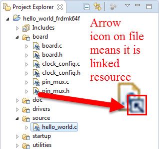

Eclipse uses icons in the Project Explorer view to differentiate the linked resource files from the local project files.  In the screenshot below, all the source files in the project have the arrow icon over the file icon, indicating these files are linked resources for this project.

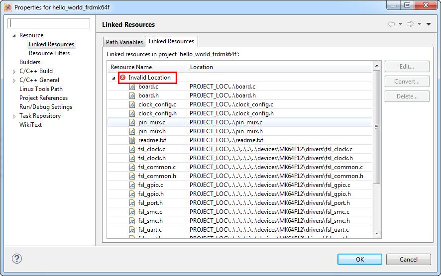

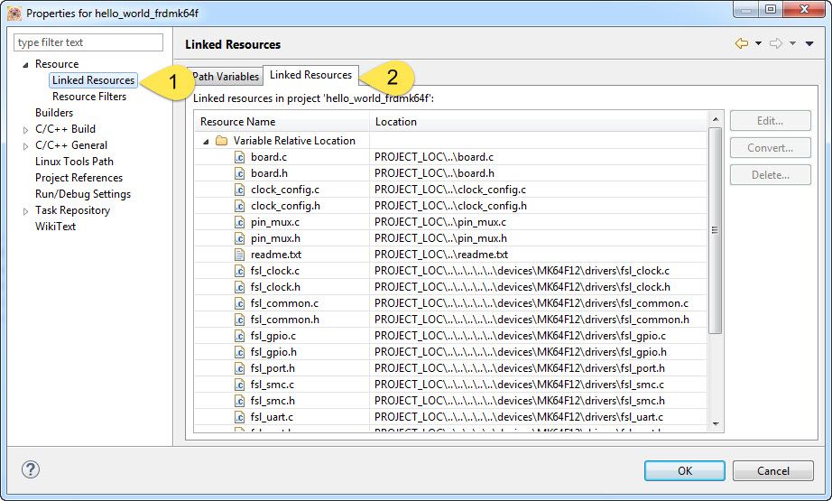

Eclipse provides a summary of all the linked resources, which can be helpful when resolving errors with the paths to these linked resources.  To see the summary, open the project properties by right-clicking the project, and select Properties.  In the left menu tree, expand Resources and select the Linked Resources tab.  Below are all the source files that are linked resources in this example project.  The summary shows the path for each of these linked resources.  In this example, the paths are all project-relative using the path variable PROJECT_LOC.  Project-relative means the locations of these files in the file system is dependent on the project directory with the .project file.  Some NXP/Freescale examples of projects with linked resources include MQX, Kinetis SDK, USB stack examples, and board sample code.

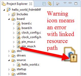

If the paths to these linked resources are not valid, the build tool will not be able to find these files when building the project, and the make tool will typically throw the error "No Rule to Make Target".  In that case, these paths need to be fixed.

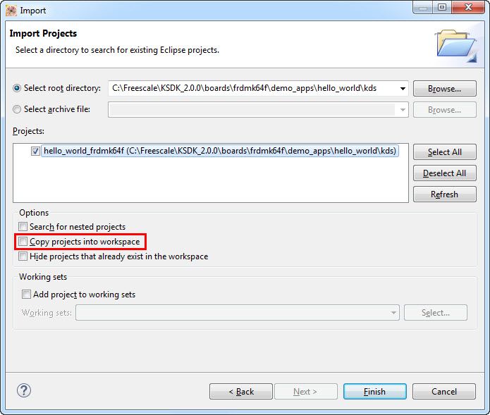

One common reason an Eclipse project has broken links to resources when imported is because of a setting in the Project Import panel.  When existing projects are imported into the Eclipse workspace, and that project contains linked resources, then the box in the Import settings "Copy projects into workspace" should be left unchecked.  Checking this box copies the project directory into the workspace directory, and imports the copied directory.  If local project files are included in the project, they will be copied to the new project directory in the workspace.  But for linked resource files, they are not copied with the new project.  These linked resources remain in their original location.  The links are frequently broken, because the project directory has changed location relative to the source files.   Then, the tool cannot find the needed source files, and the error "No Rule to Make Target" occurs when attempting to build.
Just to show the problem, here is an example of importing the KSDK Hello World project with the box checked for "Copy projects into workspace".  Now the project-relative paths of this project are no longer valid.  The reason is the project directory is now located in the workspace directory, but the files that are linked resources haven't moved from their original location.  So the project-relative paths need to change.  Eclipse indicates linked resources with path errors by replacing the icon with a yellow exclamation mark.  Any files shown like this in the Project Explorer will likely not be found by the build tool.
The project Linked Resources summary also lists all the linked resource files with invalid locations.  The paths to these linked resources call all be edited here if needed to resolve the path issues.
Therefore, if an imported project gives errors "No rule to make target" and cleaning doesn't help, try deleting the project from the workspace, and re-import the project without the box checked for "Copy projects into workspace".  If that doesn't resolve the issue, then review error messages and the Linked Resources to try and find what file(s) is missing.

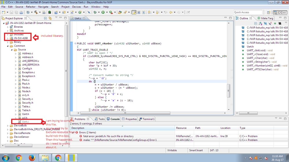

i was compiling application JN-AN-1162 i have added SDK of 4168 in this having all header files.
 i have added header files in code as well as in include box(by right click on project directory).
while i was compiling single file like "uart.c", but it was showing error of another file that " you haven't include jendefs.h file. i remove that another example which was giving error of jendefs.h is not present (i removed because that example was not necessary at that time).
after that example and again compile uart.c still it went to another example and saying jendefs.h is not present like wise i delete all another  example except  uart.c and header files which are required.
i try to compile but again it goes to header file like "AppHardwareApi.h" and showing error in that header file that  not having "jendefs.h" is not present.
now i can't remove 'AppHardwareApi.h" because its required in uart.c code.
i don't understand why this is happened.
is all because of HAController.exe error or something i was not doing in proper way.

If you have compiler errors that say jendefs.h cannot be found, then there must still be a source file in the workspace that is including that file.  First, I would close all other projects in your workspace, so you don't have errors from those projects showing up.  In the Project Explorer view, right-click each project and select Close, so you only have this project open.  If that doesn't eliminate that error, then there is still a source file in this project including that file.  You can search the files in the workspace to find where the include is.  Use Ctrl+H to open the search tool.  Click the "File Search" tab, and search for jendefs.h.
Or better yet, fix the project includes so the compiler can find that header file.  Find the directory in the file system that includes jendefs.h.  Then add that path to the Project properties, under the C compiler includes.

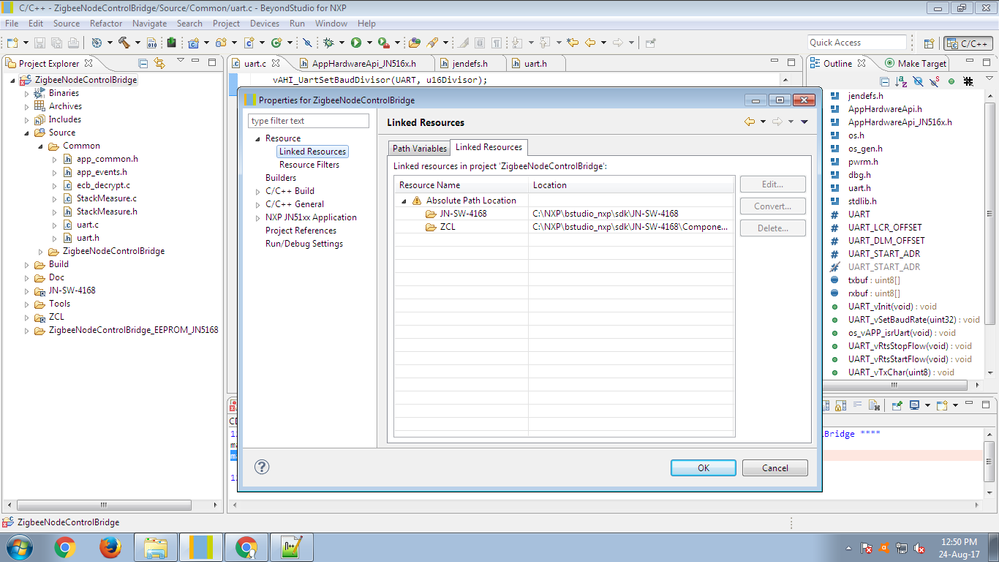

Hello sir,
i read your paragraph. i understand little bit.  can you explain how to link the project.
Because i am stuck at same point. now i have only one error is mention below
"make: *** No rule to make target `HAControlDongle.exe', needed by `all'. Stop"
i am trying to link resource but its not working.
please give me proper direction.
i have attached screen-shot. please check it out.
or else if i am wrong please reply me.

dereksnell
Hi dheerajsawant‌,
From the error message, it appears the project is trying to include the file HAControlDongle.exe in the project build.  Since HAControlDongle.exe is not a source file, it probably needs to be excluded from the build.  You can find the file HAControlDongle.exe in the Project Explorer view, right-click on the file, and click Properties.  Select the "C/C++ Build" menu on the left, and then check the box "Exclude resource from build".  That should prevent the toolchain from including that file in the build.

Hello Darek Snell,
Thank you for your time, i did as you said. but now i seen something different which i have taken screen shot.
Dheeraj Sawant
24,589 Views
dereksnell
Hi dheerajsawant‌,
From your screenshot, it appears you have excluded uart.c from your build.  That means the compiler won't build uart.c, which I believe is not what you want.  Earlier, I was suggesting you exclude HAControlDongle.exe from the build to get around the error you reported.

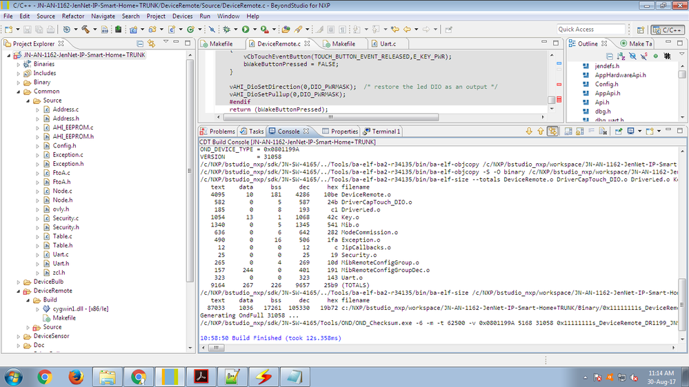

dheerajsawant
Contributor V
Hello dereksnell‌
Thank You for your time.
Now my code is compiling and creating binary files.
as error are showing still in project window, but i am ignoring them.
am i going  on same path?"
i just wanted to be sure.
i have taken screenshot and trying to build DEVICEREMOTE.c File.
As automatically included header files.
