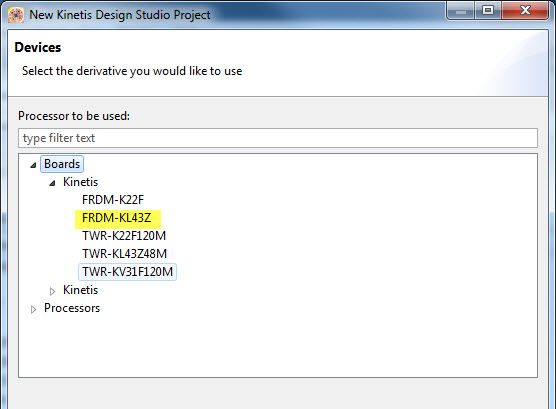

I have some points to share, I hope that with this the information will be clear for you:
  • Indeed, as you mentioned, CodeWarrior does not support KL43 devices, nor the PEx (I am referring to the PEx that uses the LDD drivers). If you have some doubts about the difference check this thread Re: SDK vs PDD(without SDK)
  • To have support for KL43 devices under KDS you need to download the standalone version for KL43 devices based on the KSDK 1.0.0 from HERE look at the supported devices table at the bottom of the page. Install the eclipse update, please follow the steps in the attached file that colleague Jorge Gonzalez has posted before.
  • Once the eclipse update is installed in your KDS you can create a new project for the FRDM-KL43Z board.

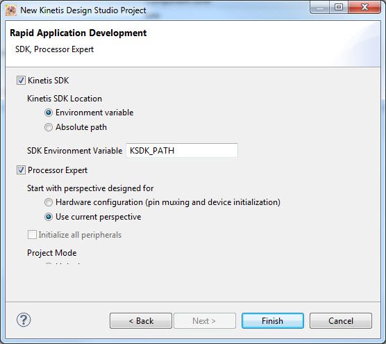

  • You can check the KSDK and Processor Expert options.
Please check the points mentioned and let me know your results.
