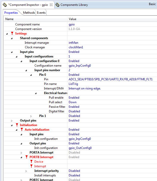

I am using the FRDM-K64 board with KDS 2.0 and KSDK 1.1.0. In order to set up an external interrupt on pin B10 i used the fsl_gpio component. I activated code generation under the Events tab for port B in order to enable "PORTB Interrupt". However, I get the following errors in Processor Expert:
It is not possible to choose or write anything in the fields behind "Device" and "Interrupt". Can anyone give me a hint where the device and interrupt settings are made?

thank you for your help and the test project. The difference to my project is that I am using MQX whereas you test project i BareMetal. If you change the operating system in the test project to MQX you get a conflict with PORTx_IRQHandler in the gpio component:
I don't know if this conflict is the reason for the errors I got in my project. Anyway, I deleted the gpio component in my project and added it again. Now the Device and Interrupt fields are correctly set to PORTB and INT_PORTB as in your test project. Renaming the Event procedure name solves the name conflict and everything seems OK now.
