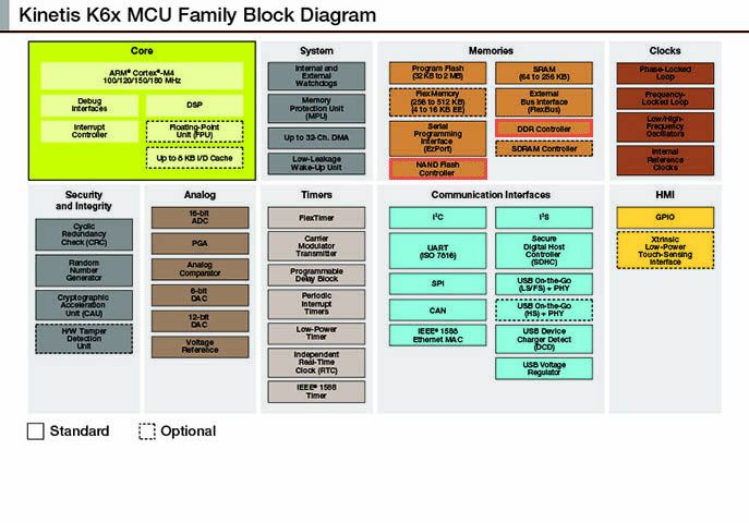

Another question: Do you have any other Kinetis MCU that has DDR and NAN controller built in? Or you are going to release any new MCU next two years?
Christie
16,013件の閲覧回数
ivadorazinova
Hi Christie,
yes, for example Kinetis K6x family has DDR Controller and NAND Flash Controller as well.
Please, for details about MCF5282 contact ColdFire/68K Microcontrollers and Processors​
for questions about MC56F8367 please contact Digital Signal Controllers​
Iva

a8Chcx
Hi Iva,
Yes. But it is launched 5 years ago and not supported by KDSK, right?
I saw K80, but there is no support on Ethernet and CAN...
Christie
16,006件の閲覧回数
ivadorazinova
Hi Christie,
If we would talk about K6x family, for example K64, it was launched January 2014.
I´m attaching you Release Note, which contains all supported devices also for K6x family.
Hope this helps.
Iva
